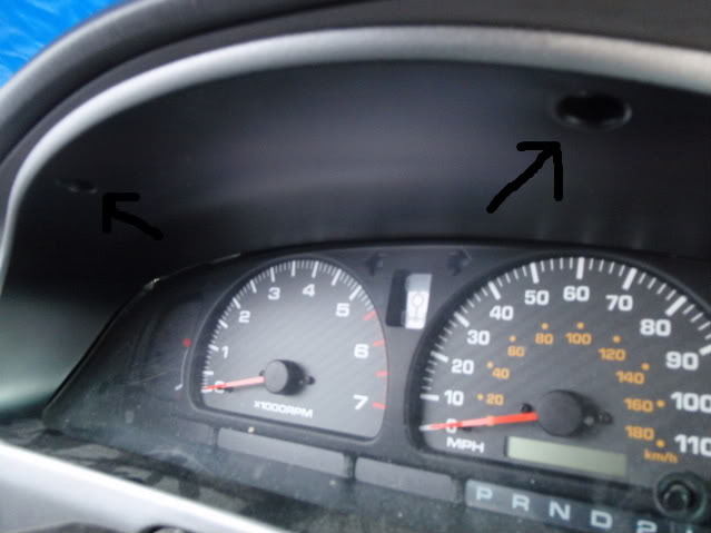

4. Remove the 4 screw that hold the piece around the gauge on.
Top two screws are here:
Bottom two screws are here:
The face piece around the gauge cluster then pops off.

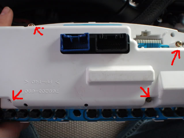

7. Take the white cover off the back of the cluster, by taking out 4 little gold screws.

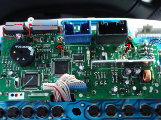

8. Taking caution in not breaking anything on the circuit board, remove the two screws at the top of it and the two flat wires at the top as well. The wires come off by gently lifting up on the front of the black holder, which doesnt come all the way off.

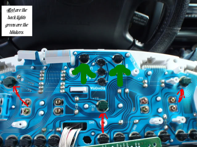

9. You can now see where the three cluster back lights and two blinkers go. The back lights are arrowed with red the blinkers are green.
10. Remove each plug with a slight left turn, its about a 1/4 turn and they can be pulled out. Here is what one of the lights look like when they are out.

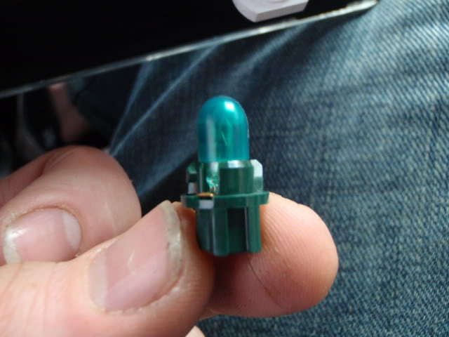

11. Pull the bulb out, and set it aside.
11A. Insert one of the new #74 bulbs.

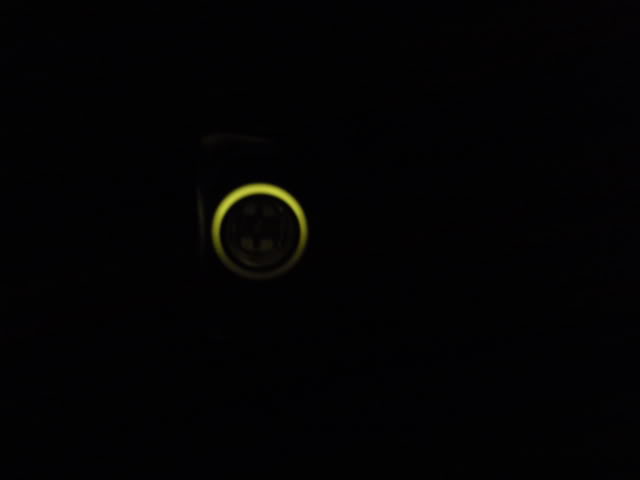

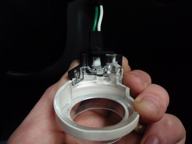

20. Pull the white plastic piece out of the bottom of the ignition light holder.
21. Pull the ignition light ring off the ignition.
22. 1/4 twist and to remove the bulb holder.
23. Replace halogen with LED.

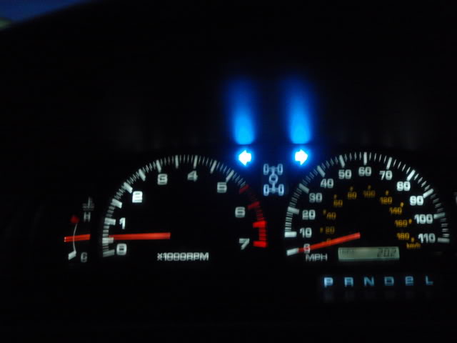

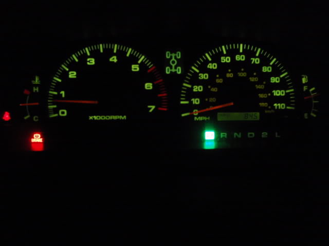

Congratulations, You have now successfully replaced you halogen gauge cluster lights, blinkers, and ignition light with LEDS.
Here is what it looked like before:
And now after the install:
