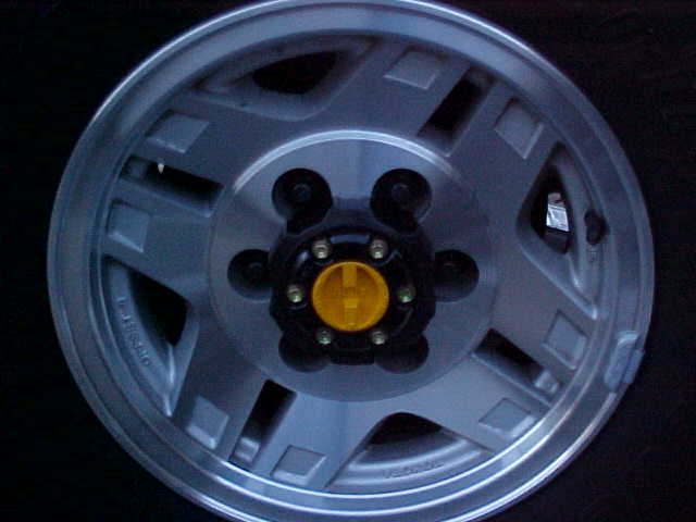

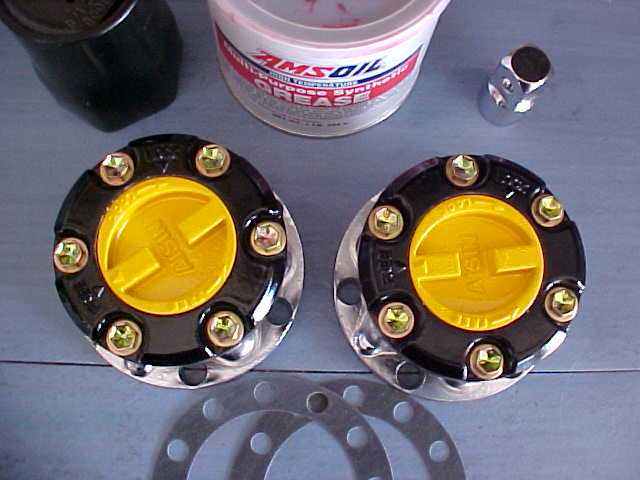

Delboy,
Looks like you are going to have some fun rebuilding and repainting the Aisin hubs. Make sure to take easy on that grease, light coat will do the job.
Check mine out
https://www.yotatech.com/attachment.php?postid=54487
https://www.yotatech.com/attachment.php?postid=54490
Noel
