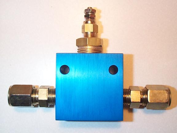

Transmission Temperature Manifold
Here is a picture of the Autometer PN 2286 Transmission Temperature Manifold.
Attached Thumbnails Installing a transmission temperature gauge.-transmission-temperature-manifold-002_a.jpg

I am getting closer to locating the Fluid Connector fittings I need for the transmission temperature manifold installation. The fittings are steel and have 1/2 NPT on the block end the correct size sealing nut and ferrule on the pipe side to accomodate 10mm OD tubing. If anyone is interested I will increase my order and when they come in notify the interested persons. These may have to come from Europe from a sister company and that means it may take a month. I do not have a price yet. Please, say yes only if you are absolutely serious and certain that you want to do the same kind of installation as I am doing.

How much is the manifold though? That manifold looks good and looks simple to install. Let me know the price and if I can afford it I will get one too. Thanks.

Hi Noel,
I cannot say that this is the cheap date way to go. The Autometer manifold is $35.00, then you have to add the cost of the fittings I am talking about on top of that. I am guessing that this is going to end up being about $50 - $60.00 total. I know you may think I am nuts but when I do something I try to do it right (my judgement) and not half-assed. I also like to make things look solid and as close to the way the factory would do it as I can. I am going to order 4 pcs so that I will have an extra set of fittings and I will place my order as soon as I locate the parts, which I hope will be tomorrow.

I just received confirmation on the steel metric fluid couplers and they are $23.00 each with a 4-6 week delivery date. Stainless steel would be $38.00 each. If anyone is interested, send me a PM and LMK by this afternoon.

I have a couple of those manifold things laying around. I gave up trying to install it in the steel line and just spliced it in the soft line with simple barb fittings.

I added a spin-on filter to the tranny cooler line and put the temp sender at the inlet to the filter. Very easy install and additional filtering as a bonus.

toy283 -
I will use a Filtran in-line filter but want to use the manifold block in the steel line for a hard mount, if I can call it that.

I want to let you all know that I have observed the changes in fluid temperture with the new billet in-line temp manifold I installed in the 10mm steel line and I believe that my readings are probably the most accurate of any installation because of how close the sensor is to the exit point of the cooler line coming from the trans case --- about 8 inches.
With an ambient outside air temperature of about 83 degrees under the following conditions I get the following readings:
150*(+/- 5*) @ steady speeds between 40 and 65 mph
165*(+/- 5*) @ steady speeds between 65 and 75 mph
180 to 200* (+/- 5*) @ speeds above 80 mph and in stop-and-go bumper to bumper traffic.
I cannot imagine what temperature levels are realized for those who do not have a TRANSMISSION COOLER and / or tow or run in the mud in 4WD for extended periods. I think everyone should install a transmission cooler as one of the first things they do when they get a 4R. JM2C
