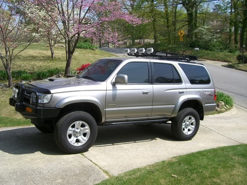

Wilderness Rack & IPF & KC Lights:
I purchased a Wilderness Rack, six light brackets & four IPF lights from Chris @ 4x4Connection. His commitment to customer service is exceptional. I felt like he went above and beyond more times than he could have to meet my needs. From him opening the actual product in question to give me a first hand look at it, to permitting me to return a product without its original box with minimal charges.
The Rack itself is a first-class product. The directions were easy to interpret and everything bolted together seamlessly. The rack is very well built and much more aerodynamic than most racks in its category. Granted it is heavier than a Surco, but IMO it is far superior to one. It is also much more substantial than a Surco rack. Plus it sits lower to the roof than most racks and fits the overall shape of my 4Runner extremely well.
The 4 front mounted rack lights are IPF 868 100wt Driving Lights. I?ve run Hellas & KCs in the past, but the main reason I went with IPF was simply to try something new. (Price was the same across the board for each make and model of light I was deliberating on.) The IPF kits are generous enough to include both a 55wt & 100wt bulb in the majority of their light kits, thus allowing you to decide which bulb to use.

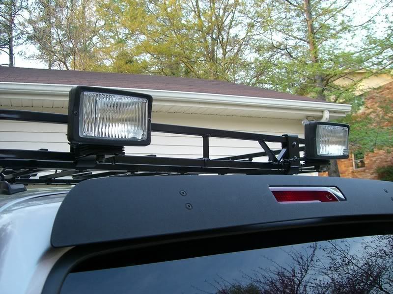

The 2 rear mounted rack lights are KC 55wt Fog Lights. I purchased these lights @ Auto Barn. I?ve bought many accessories from them in the past and they have always treated me fair.
I chose KC lights for the rear for one simple reason...the KC light kit was just a few dollars more than a single IPF/PIAA Flood Light. However, after one month of use, the KC fog lights have a much more wider light spread and not enough downward light spread than I need atop the roof of my 4Runner. These lights are terrific, however they just do not perform very well atop a vehicle?s roof.
I will soon be upgrading to a set of PIAA Flood Lights. I have located a dealer that will sell me just the lights themselves. No wiring, relays or switches associated with the lights, just the lights to save on cost. (By the way, if anyone is interested in my current KC fog lights, PM me for a price. I will be selling just the lights,no wiring, relays or switches.)
REAR:

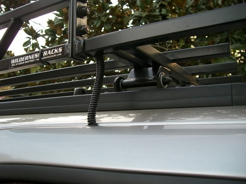

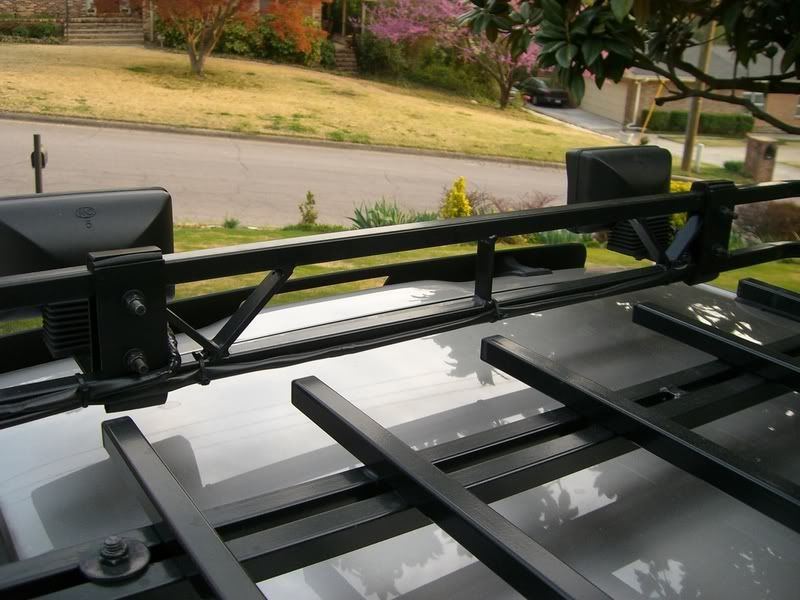

Having had basket style racks in the past with light brackets attached, I have learned it is a good idea to install some type of padding between the light bracket and the rack itself to keep the light brackets from rattling while driving. These brackets might never rattle against the rack, but I went with prior experiences.
I purchased a roll of garage door weather-stripping from Lowes. This piece of weather-stripping connects to the bottom of a garage door. It is somewhat dense and about 2 inches wide. So far, it is the best padding I have been able to locate for my type of application.
When I wired the rear lights, I tapped both of them together into a larger ground and power wire and then ran both wires down the passenger-side door weather-stripping and into the engine bay.
REAR:

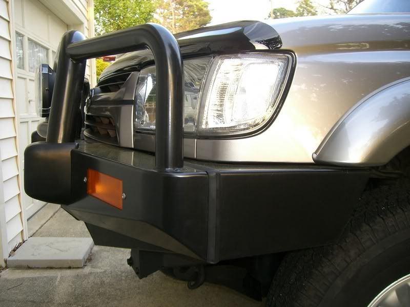

TJM-T15 Bumper & IPF Lights:
I purchased this bumper from Steve @ SonoranSteel. Steve is a great all around guy and sells high-quality products. He is very knowledgeable on Toyotas and let me pick his brain multiple times when ever I had a question.
Not that I do not like ARB bumpers, I just prefer the look of the TJM. Plus TJM ships their bumpers out of Tennessee, and since I currently reside in Alabama, shipping was very fast. (Before anyone asks, the bumper, fogs, turn signals & support beam have already been sold to a fellow YT member.)

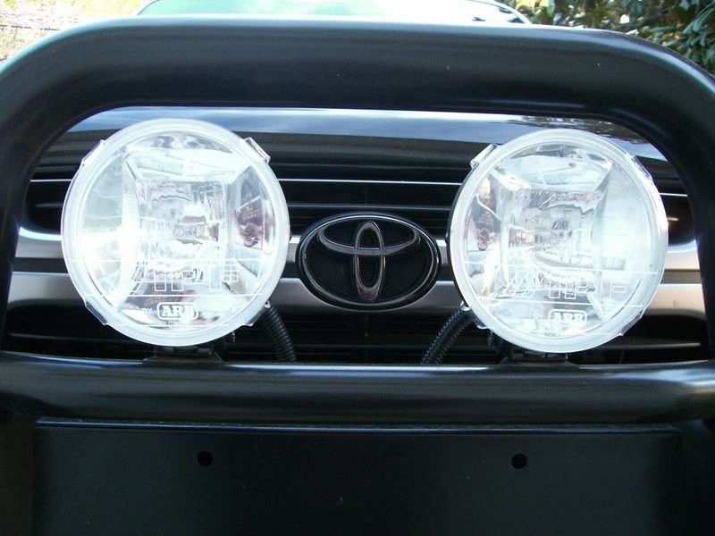

I also purchased a set of IPF 968 55wt Driving lights and a set of IPF clear covers from Chris @ 4x4Connection. I went with 55wt lights for the bumper, because I previously had a set of OEM 55wt fogs pre-wired from the factory and I wanted to maintain the existing turn- style fog light switch on the headlight selector. I simply tapped the new turn signal wires & fog light wires into the appropriate OEM wires and that was the extent of the wiring for the turn signals and IPF lights. I have already done the fog light mod, so as long as my parking lights are on, I can turn these IPF lights on and off. They will operate with the high beams on as well.

TJM installed w/ new IPF 968s:
**WORD OF ADVICE**
The TJM instructions are very vague. It took me a few minutes before I figured out all the factory bolts that previously held the OEM bumper in place are to be reused to properly secure the new TJM to the frame. (Wish they had thrown in some new bolts in the kit while they were at it.) My OEM bolts seized due to rust and it took us the better part of the day to install this bumper. A few even broke in half during the process of removal, thus requiring us to make a trip to the local hardware store to purchase new bolts. While I was there, I went ahead and purchased all new Grade 8 Metric bolts so I would not have to reuse any of my worn out OEM bolts. If you ever decided to install a new bumper, you might also want to consider buying all new hardware that is to be reused?especially if your bolts have sustained damage or rust over time.
Wing Gaskets - Wing gaskets are provided with the TJM T-15 to be used in between the bumper and left and right side bumper wings. At first glance, these gaskets appear to be a universal design. However, each gasket is designed to only fit on one side of the bumper. The directions did not state that the gaskets are side-specific and we ultimately installed them on the wrong sides. After completion of the installation, it was clear that both wings were out of alignment, but it was not until I spoke with Steve later that night that I learned we had installed them on the wrong sides.
The next morning, I unbolted the wings, swapped the gaskets around and reinstalled the wings. Now everything is installed properly and the wings have a uniform fit.

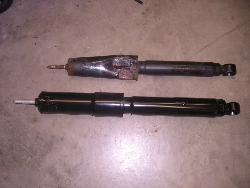

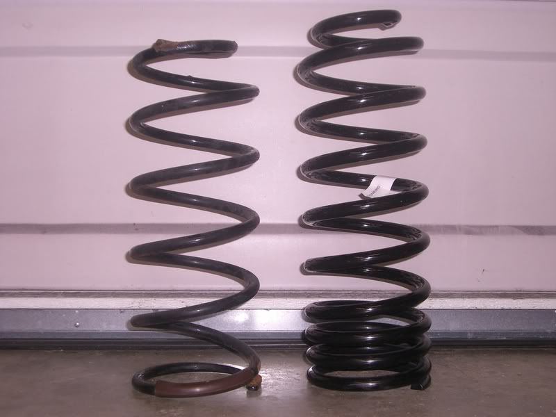

New Rear Spring vs. OEM Spring:
New Rear Shock vs. OEM Shock:
It was a fight to get those old shocks off.

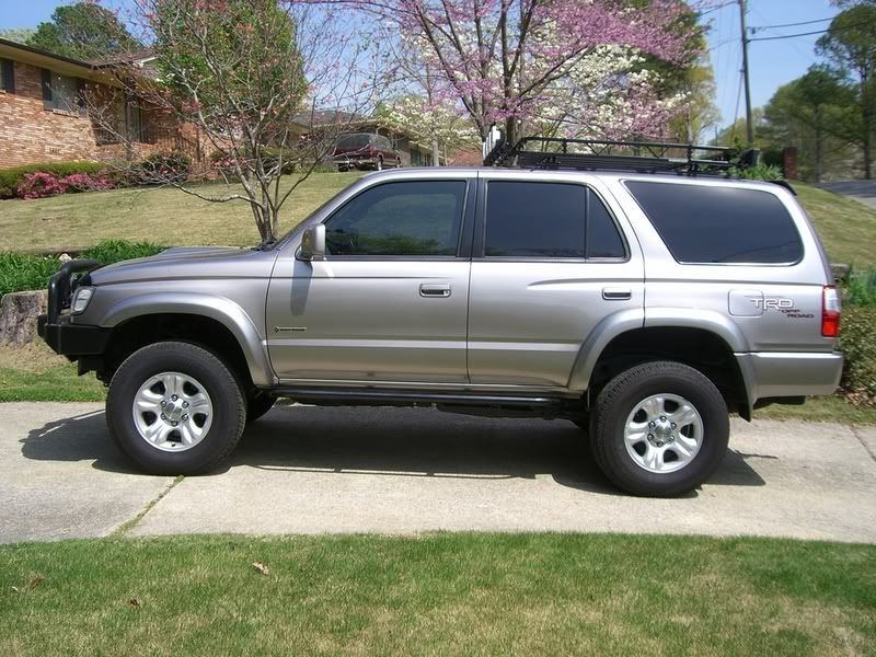

AFTER:
FRONT AFTER:
2.5 inches of Lift.
REAR AFTER:
3.0 inches of Lift.
**PLEASE NOTE**
The Suspension Lift was installed prior to the installation of the TJM Bumper. I gained 2.5 inches in the front and 3.0 inches in the rear after the completion of the Lift. However, after the install of the TJM bumper, my front has dropped 0.5 inches. The picture labeled FRONT AFTER, includes the measurement of the lift before I installed the bumper.
Currently, my front is 2.0 inches and the rear is 3.0 inches higher than stock.

Eleven months later, this is how my 4Runner currently stands:
Again, lager tires are in the near future, but I am currently running 265/70/16 stock 31s.
