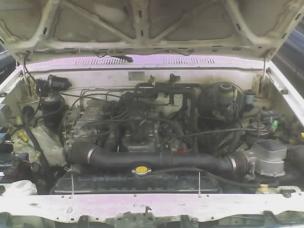

I hope I just put these on here right.
It's got this crazy looking spoiler/wing thing on the back.. that will no longer be there if I buy it.
Ok the 3rd picture is of a thing that was right next to the throttle cables.. it was just hanging there and looked out of place. Anyone konw what it is and if it's supposed to be hooked up to something?

-----Under the hood:
-the battery was all screwed up, the terminals are corroded away and the battery is on it's last limb.
-The radiator cap is leaking WATER (No antifreeze, just water). Which means that it wasn't properly maintained, but fixable.
-It makes a clicking noise somewhat similar to a exhaust leak, but I looked at the exhaust and it's completely stock so an exhaust leak is expected after 18 years.
-The head on it does look brand new and it's not leaking oil and it doesn't smoke at all, even during warm up.
Its normal . Thats the air filter end, the other end connects to the DP diaphragm(which reduces HC and CO emissions by opening the trottle valve slightly more during deceleration than idle... ).
heh it's normal! that's a good thing, I just get a little paranoid when I see things hanging around looking like they should have more of a purpose.
