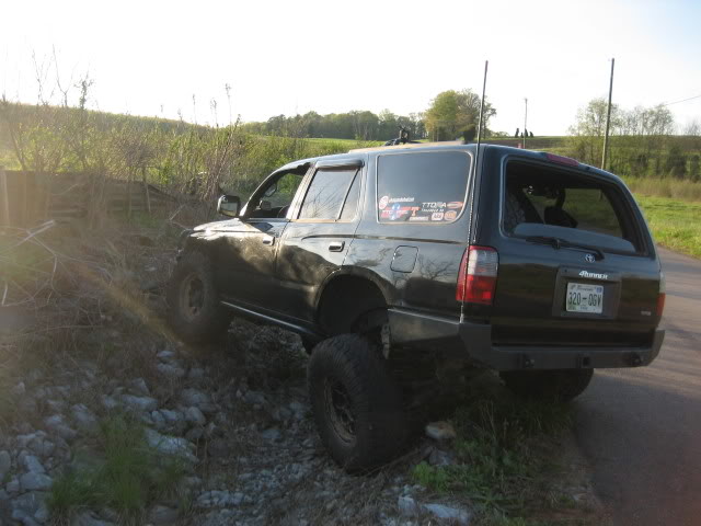

crolison's Avatar
Joined: Mar 2007
Posts: 2,571
From: TN
Originally Posted by Mrbikerman
So I have a stock front bumper and the lame limited fender flares on my 97 4run. 3" toytec coils/lc coils, 2" RB bl, and 1" wheel spacers. can I clear 35/11.50's? I am ready for some trimming, but I don't want the tires rubbing on the frame.
Well you'll rub on the frame at some point, it should really be nothing to worry about.
only thing i'd have to do to run 35's is tub the firewall and trim fenders
