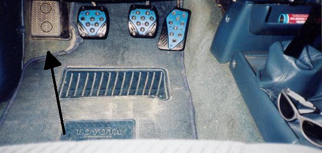

Sorry about bringing up such an old thread...i'm in the process of taking my carpet out and everything is out except for the little footrest "dead pedal" where your left foot rests...it looks like it has two caps that cover up two screws or bolts but i dunno how to pop, unscrew the caps...can neone help me on this one??

i may have just overlooked it but i still didn't see how to remove the part...it's in a 91 yota auto by the way...

i'm still in need of knowing how to remove this piece...i'm gonna go pick at it some more...if neone knows how to get the thing out lemme know...i'm sure it's amazingly simple i just don't wanna go about it by snatching and such just to end up breaking it...

and of course....it's extremely easy...all you do is take a large flat screwdriver...stick it in the grips on the pedal and unscrew them :pat: mine had mud down in them makin them hard to turn after like 1 1/2 turns and i was scared i was gonna break'em...but newayz...if you didn't know u do now

^^^^^^ like he said. You have to use a flat head screwdirver to loosen them and then pry it off the floor. The clips usually break so make a trip to the wrecker and pick 2 more up. They never tighten down the way they used to but it isn'y very loose either. Over time you don't notice it.

forgot the attachement
