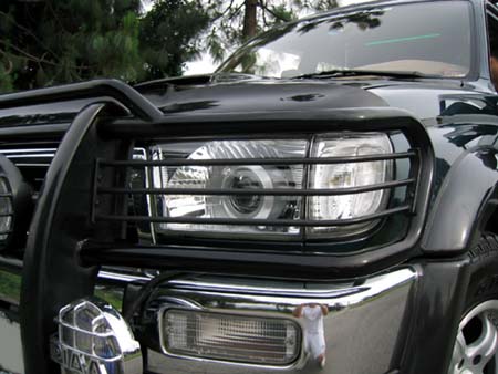

Couple of pics, still need to tweak some things. I'm using BMW E55 bi-xenon projectors. The E55s are one of the oldest bi-xenon projectors, so they're not as slick and bright as some of the newer ones, but for how much everyone knocks the E55s they're pretty awesome for down the road just on low beams. **Pics of the front are at the bottom of the post.**
These are taken handheld without a flash so the color's a bit off but it should give an idea. I'll get some day light pics of the lights themselves tomorrow. Let me know what you think.

Projector close-up
Projector close-up from the side

Hey FattyCBR, I also did the retro and used the Bi-Xenon E55 projector......I was wondering if you have any close up pictures of your headlight??...I'm interested to see how yours look like and what bezel did you use to cover it up?
I added some at the end of my first post. I used bezels from the new E60.

Could you just change the bulb to get more output, a dif temp? Also, was that as far in as you could mount the projector? It seems like it sticks out pretty far, just wondering if you did that on purpose. Also, how hard was it to get the aim right, the cutoff not to high or low?
The bulbs I have in are Phillips 4100k bulbs, which produce the greatest lumens. You could mount them as far back as you want since there's plenty of room behind the lights, but the further back they are the more exposed to water they are. Getting the cutoff height wasn't too bacd, I still need to tune them a little, the hard part is getting them rotated so they're both perfectly horizontal.
