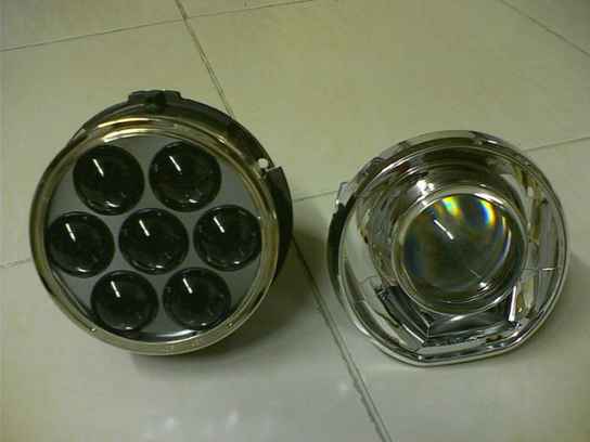

here's a pic of the Q45 projector (on the left) next to a ls430 projector
sorry to hijack your thread
Attached Thumbnails HID Bi-xenon retrofit complete! (w/ pics)-image473copy.jpg

Wouldn't be practical on a 4Runner due to the low beam only design...
The projector just fit inside this housing. I believe the customer has special lights on the front of his car for highs so these are low beam only. While they dont produce the best performance, these Q45's really do look unique since they are one of a kind.

yeah i've thought about that, but I rarely ever use my high beams, and if i ever decide that if i want highbeams, I'll get some of the hella 90mm modules or the 120mm ones and mount them in the grill or something
