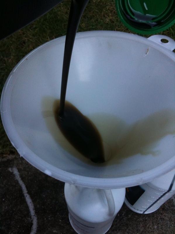

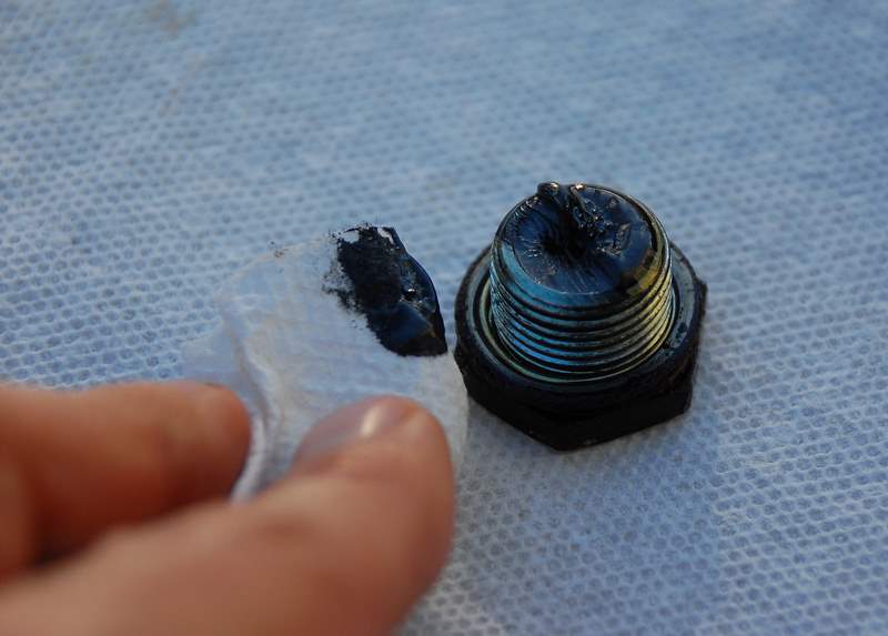

Ok, here's an update. Since the weather was so nice here today, I decided to change my diff oil. I drained out only about 2.5 qts, and it was nasty looking. Seems it was low and dirty after all. When I checked it a couple of weeks ago, I stuck my finger in the fill hole and it came out wet. It's hard to tell with a fingertip, but it seemed to be filled up to the fill hole. I guess it wasn't. The Haynes manual says the locker diff takes 2.9 qts. Well, I got just under three full qts of Valvoline 80W-90 in there and less than 2.5 came out. When and how that missing pint disappeared is beyond me.
I took some pics of the grotesque black looking oil and the magnetic drain plug for your enjoyment. Only a couple of tiny tiny little fragments of metal in the silvery glop stuck to the drain plug.
I am glad to report that the whine has been greatly reduced with the oil change to the point of it being a non-issue for me. It is barely audible with the windows up and the radio off.
For now, I will be breathing a sigh of relief that my 3rd member is not fried. A little scorched, maybe, but not fried.
