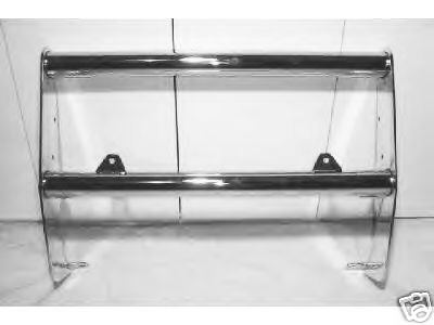

I'm not sure how the clips would be held on... I was thinking they might be secured to the frame or some other sturdy hardware after the bumper/grill is removed. Then, the clips would sit on the bumper once it was put back on. This is pure speculation, as I don't even know what they look like.
I thought about the theft factor, but was going to use a special nut or strip the regular nut to slow any would-be "admirers." It's good to know that even with the standard hardware, the lights are not secured to the bumper very well...You're probably right, the clips would likely be even less secure. I was also wondering if they'd make the light beams bounce quite a bit.
As for the grill guard, I understand people feel they add considerable weight to the truck and make washing/waxing more difficult. I wasn't going to get a full grill guard with the big bar over the headlights, etc.; I was looking at the ones that cover only the center of the grill, as pictured below. They cost $100, have room for 2-6 lights, and would offer a small buffer between my bumper and the idiots on the road. Have you heard anyone complain about this type of smaller brush guard? I'd be interested to learn of the possible drawbacks before shelling out a C-note. I'll search the forum before I order one.

grille guards suck... period... they do nothing other than hold light... i have 3 hella 500s on my stock 85 bumper and they are fine... they bounce around quite a bit, but then again the whole bumper bounces... it doesnt have its side supports or anything and is way differnt from the 96-98 bumpers.....
