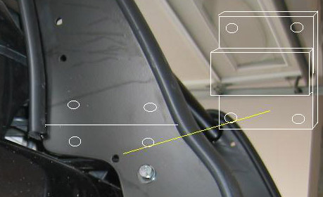

i posted this for someone else, but here are some pictures.
http://www.calrockx.com/temp/bodylift/
he said to just cut the brushguard by the brackets, move it up a 2'' and weld it back together.

Whats this hole in picture for? Is it for a brace that goes through the grill and attaches to the frame somewhere? If so its probably best to make a cut above that point. Make up a nice plate that extends the upper part of the brush bar. Do you have a pic with the light guards installed?

I myself would remove the rubber around the front. Make a cut at approximately where the white line is. Make up a plate like this. Paint it . put it in place. trace holes from the plate . drill holes into brush bar. And bolt it up.Replace rubber. It would look like a 2 piece brush bar. No one would know it was modified. And it would be very strong.
no, no pic with those side light guards on. i didn't install them, i kinda don't want them. i just like the center piece.
and that other hole...not sure what it's there for. i think it's a one of the holes used when mounting those side light guards on.
that idea you said about extending it...i don't know. maybe. where would i get something like that done tho?

A fab shop would either make the plate for you or just weld a piece in. But if you weld it, the powdercoating will be destroyed. Thats why you make the plate and drill it.
