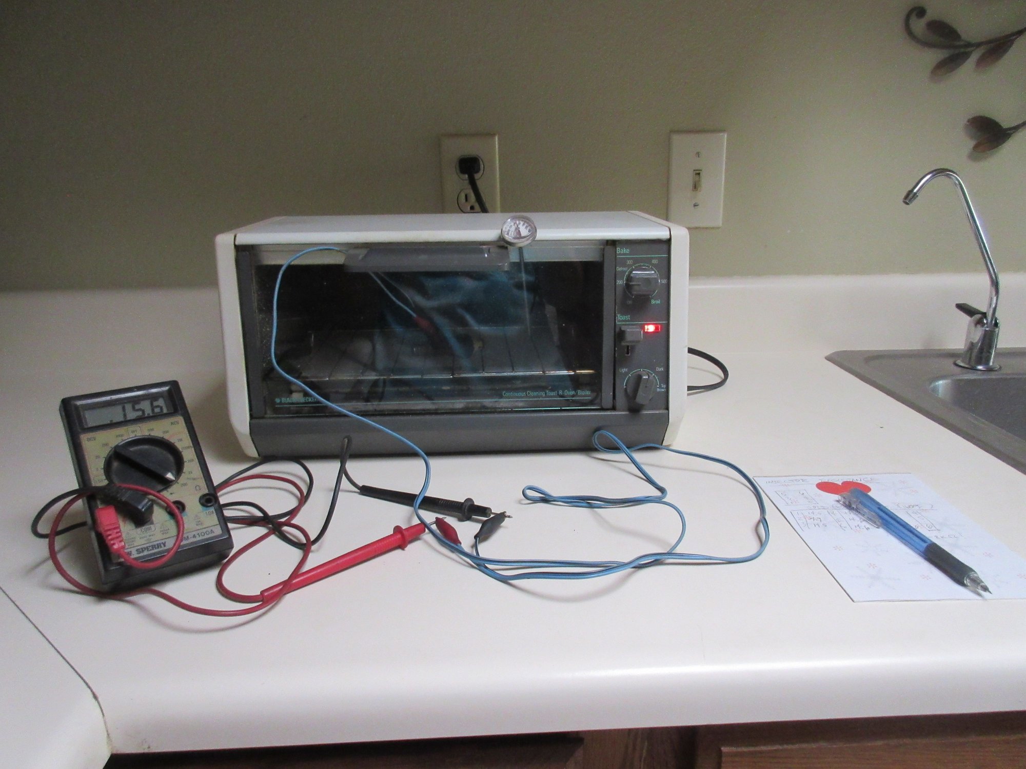

· I finally sucked it up and pulled the intake manifold & fuel rails off. I pulled the injectors one by one and cleaned them by spraying carb cleaner through them both directions while actuating them in quick pulses. They were pretty clean to start with and all sprayed well before and after cleaning. Then I measured their resistances. They all measured 14.5/14.6 ohms (at about 80°F) but one. #2 measured slightly more at 14.9 ohms but was still within spec. Now what? Remembering that the Runner worked pretty well until it warmed up, I decided to test #2 at temperature. I got my meter and a toaster oven and monitored the injector resistance while it heated up. I used an instant thermometer to monitor the oven internal air temp. The resistance started out at about 15 ohms and quickly ramped up as the injector heated up. During that time, the resistance was all over the map. Up, down, up again, down again. Then it shot up and eventually opened to infinite resistance. Then I did the same test on all the others. I waited for the resistance to stabilize before recording temperatures. (About 15 minutes.) All the rest of them SLOWLY ramped from about 14.6 ohms at 80°F to 16.8 - 17.0 ohms at 160°F. This was the smoking gun. Note that the bad injector was in spec at 80°F. (Photo of test setup below)

Test setup - injector is in the toaster oven with clips on connector pins.
