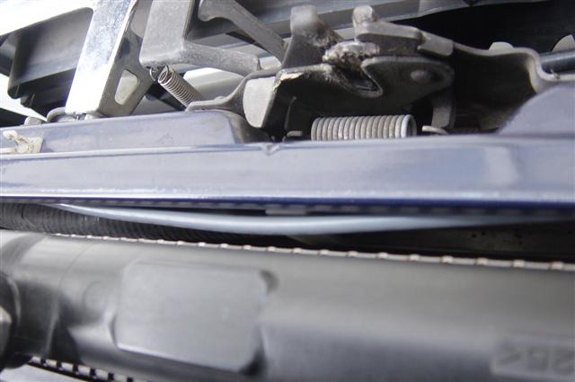

also, you guys should really think about a bypass for the entire wiring harness. I installed a hella setup that was totally plug-and-play with relay and heat disipator. Was about $80-90 with shipping and I put new bulbs that are 60/70w in ($18/ea) at the same time. These are not bi-xenon halogens, they just project true, white light. They are WAY better than stock, cheaper than the 99s, and work great. I can post some more pics, but my website is experiencing technical difficulties so my pics and writeup aren't accessible at the moment.

Wait, that just accomplishes the same thing as Roger Brown's upgraded wiring harness or am I missing something here? Also, what kind of bulbs do you have that are 60/70?

Ditto. I've talked to a few people that have put the HID kits in their 4runners and w/o the retro, the light is much too blinding to others. One guy was asked by the popo to get rid of his HID's. This causes me to think w/ our increased heights that I would rather go with Roger's alternative w/ some super whites, which I already have.

yes its exactly the same concept. The nice part about this was it took 15 mins total to install. All the wires are pre-cut, wrapped and a nice heavy gauge. The relay and pieces are already there. Yes, I have made them in the past for my 87 per Roger's instructions, but decided for the price this was way easier. The goal is to actually get as close to 12v as possible instead of the factory 11.4 or so. The result is clearly just more power to the existing lights.
