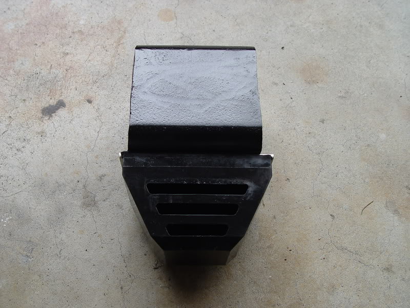

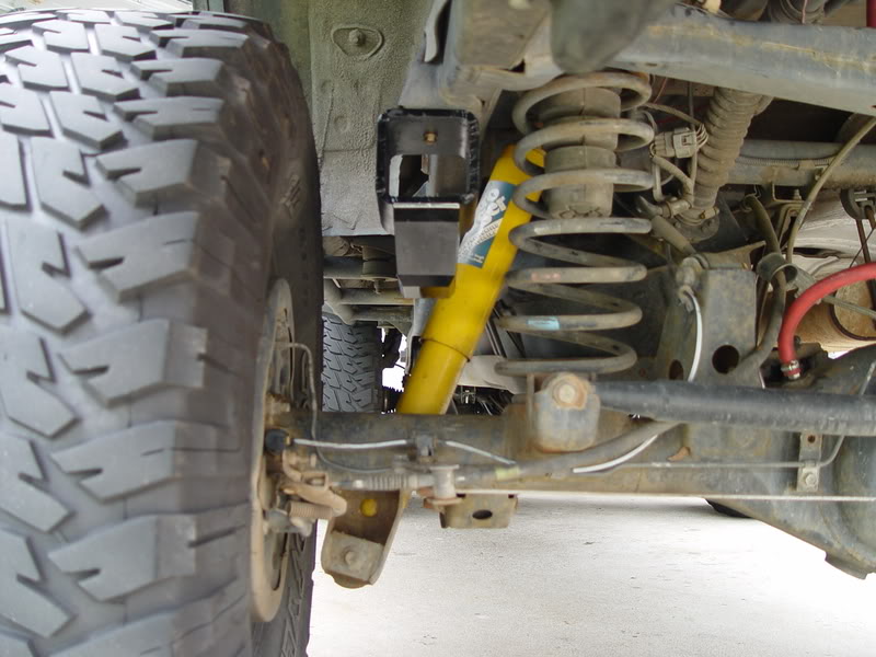

I run those bump stops in the rear.
What I did, instead of using sonoran steels adapter was to get some 4x4 inch metal stock (or whatever depth you want to go) and drill two holes top and bottom.
I then just used the stud and bolt for the daystar bumps, and attached them to the stock.
Then I used the metric bolt that was holding the stock bumpstops in, and used it to tighten the new daystar+metal stock to the existing hole.
I just used a big hammer and whacked the bumpstop, and it broke free. Then some channel locks and turned them off.
Here's what I did. Very simple, cheap, but, strong! I used such deep stock since I have about 6+" lift in the rear.
