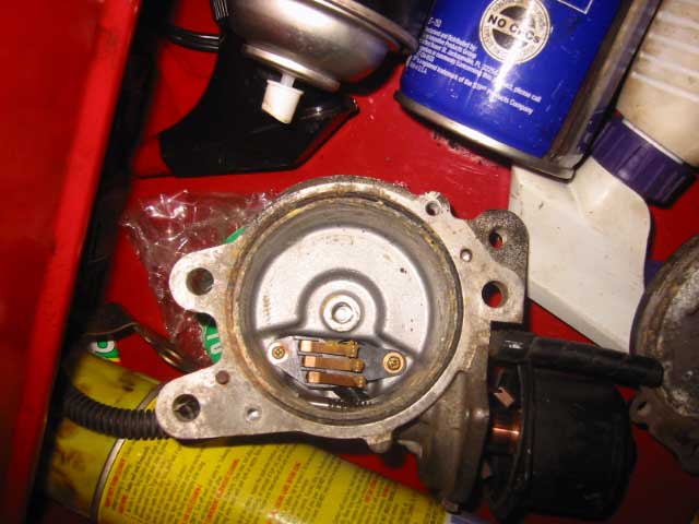

Jake,
To confirm what I'm pulling off. It is the whole component pictured below (without the gaurd) right?...

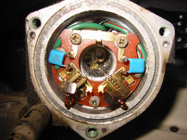

Maybe these pics of the inside of the motor will help....maybe not

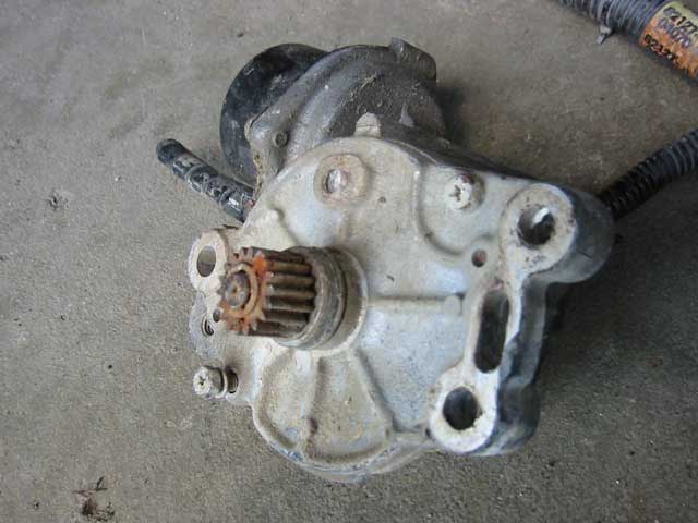

From: Cincinnati Ohio

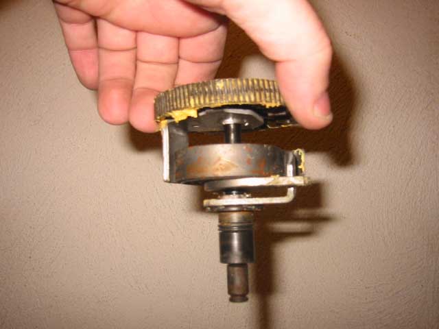

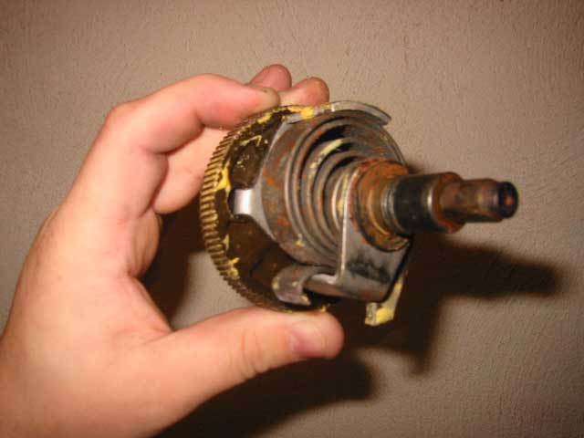

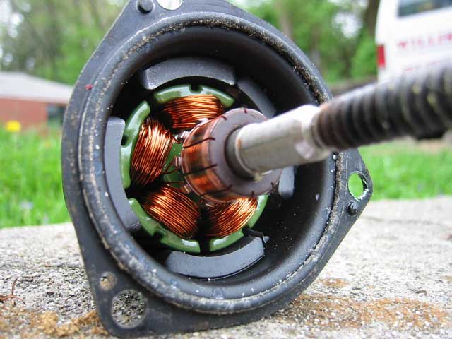

I could take pics of the big gear thats right behind the pinion gear shown in the last pic. It's laying in the drawer in my toolbox.
