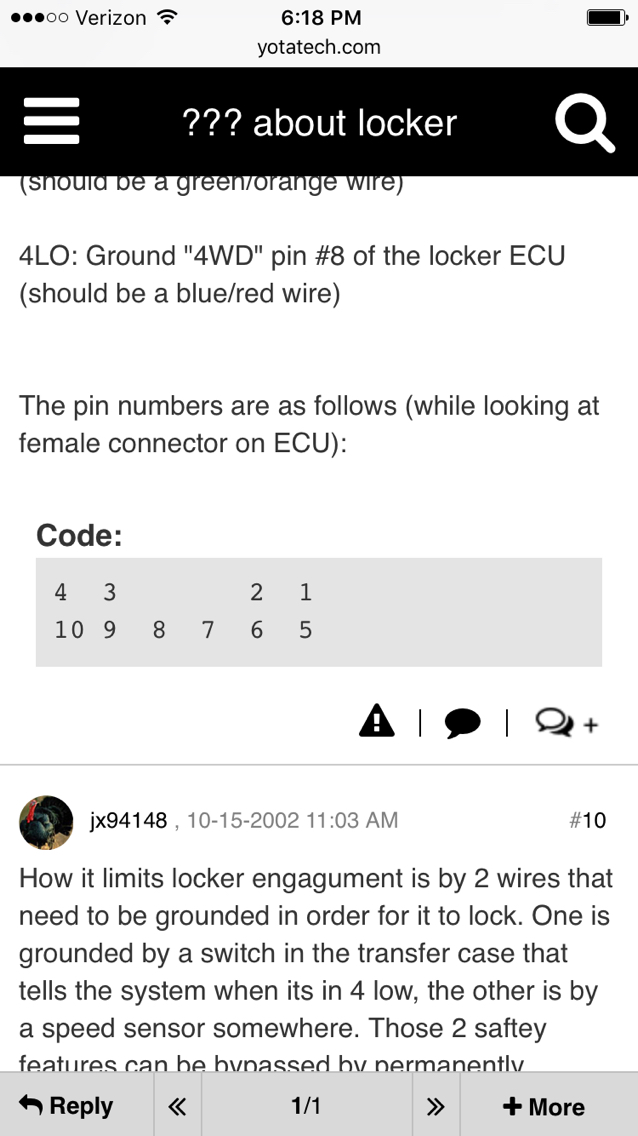

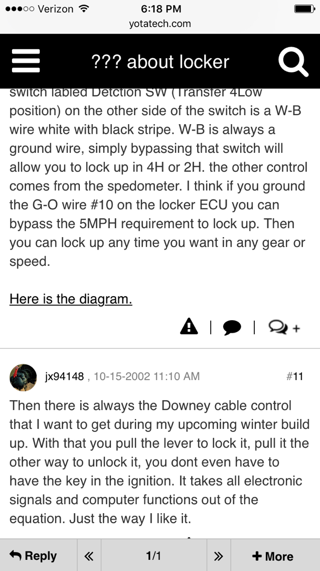

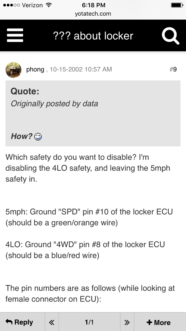

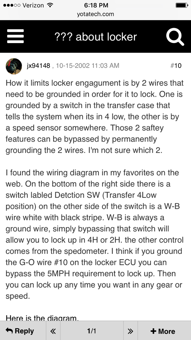

Really clean stock rig. The 4wd work fine and the E-Locker obviously only works in 4lo under 5mph. I found a very old thread that I didn't want to bump so I took screen shots of info. It seems to bypass the "safety" for the E locker to only work in 4lo and under 5 mph I have to ground 2 wires.
If someone can point me to the location of the e locker ECU so I ground those 2 wires that would be rad.

Where all the computer black boxes live of course! In the dash or kick panels..
In the locker case it's actually black! I the left hand kick panel.
Link

So I think I like the idea of leaving the 5mph to engage safety in place but to disable the 4lo safety I just cut and ground the number 8 pin at the locker ecu or cut splice and ground? Electrical mental midget here.

I mistakenly said "rear" sorry, just front seats.., and I recall splicing the ground so the ecu thinks 4Lo is engaged and allows you to use the e-locker in any t-case position, there should be many write ups explaining this. You can run the locker at any speed, but you must engage it below 5mph, it won't allow you to engage above 5mph, I also find a slight turn and a slow roll makes for a quicker engagement after pressing the RR DIIF LOCK, I've had mine doing 100KM in 2wd locked but you can only drive in a straight line, not advised to use on pavement, handling and cornering will be seriously diminished as it will want to go straight, and in 2wd it is very easy to do doughnuts on the spot.

One wire does the 4Lo inhibit, another one does the 5 mph inhibit: http://www.toyota-4runner.org/3rd-ge...-4runners.html
The 5 mph inhibit is probably worth leaving in place, but getting rid of the 4lo inhibit makes it more fun. Be aware that it can make the rear end pretty squirrelly in 4HI in low traction situations. Whether that is scary or fun is a matter of personal opinion.
