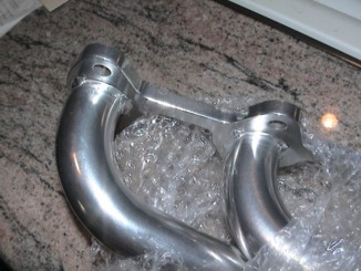

Hello all. This is my first post in the 4 Runner Forum. I've read so much and gained a great deal of information so far from everyone. Thanks for the great site!
As a result, I've purchased some Downey headers (ceramic) and am planning to get them installed tomorrow. Can't wait.
But, I'm a little concerned. I ordered the 17410-30C Ceramic. It says this on my invoice and is hand written on the box too. But...these sure look like Chrome.
For those 91 4 Runner owners (or similar) that have installed the ceramic headers from Downey, can you please confirm that they are supposed to be a dull finished color...white or grey? I wonder if Downey made a mistake.
Any help would be appreciated.
Thanks!

Okay, just so we're clear. These are not dull. They are silver, bright and shiny. Could these really be chome?
Plan to call the distributor tomorrow...but until then, was planning on dropping off the truck tonight. Won't do it if these are the wrong thing.
Take a look at the pic and tell me what you think.
Joeal, did yours look like this?
Thanks again.

yep they are ceramic headers dont think of ceramic as what is sitting on you grandmothers hutch. ceramic coating is total different

thats exactly what mine looked like

Those are ceramic. Chrome is shinier

Whew...big sigh of relief. Thanks everybody!
