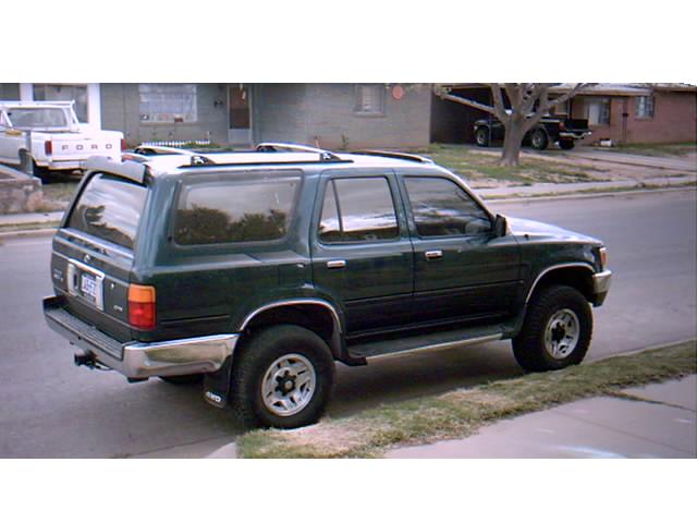

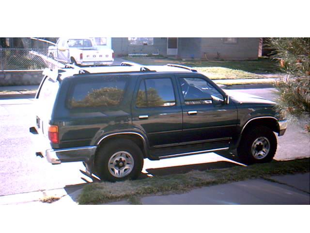

It took 3 weeks for Downey to get the right springs to me after I returned the non-HD ones. Some quick notes before the pics. The space from the top of the wheel to the fender before and after are:
front: before 14.5 after 14.5 (didn't expect that one to change right?)
Rear: before right side 11.5 left 12.00. After 13.75 on both sides
Before front pic:

after front pic:

before rear:

after rear:

and lastly a side shot of a tree eating my truck:

It looks so much better now. Seems like a good investment. I replaced the stock coils in mine last year and got about 2" in the rear (that sound kinda dirty, doesnt it). They only cost me £40, so not expecting them to last. Maybe they will!

It was about a 6 on a scale of 1-10 because I did it by myself. I don't recommend that but I've done clutches before to so I figured why not. Suggestions - get a spring compressor that is easy to turn once the spring is compressed. The bolt on mine would get too close to the spring and then I couldn't use a socket. Using an open end for that sucked. I did the driver's side first and paid for it. Do the passenger side first - the lateral bar mount gets in the way big time. Also - my springs didn't fall out like promised at full droop of the axle but having my daughter stand on the drums helped quite a bit while I was getting the old springs out and the new ones in. Thing rides like a cadillac now. I must have been riding on my bumpstops and not realized it because it is unbelievably better now.

Looks good Victor.
And in the last pic you can see daylight from the passenger side over to the drivers side with the new lift.

wow, that is quite a sag you had there. it looks 10 times better now
