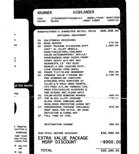

2000 SR5 Auto, Factory eLocker and 4.30s. See pic for scan of window sticker.

That is almost the exact window sticker of the 4runner I wish I could find for sale now... that or a 1999, undecided between AT and MT
