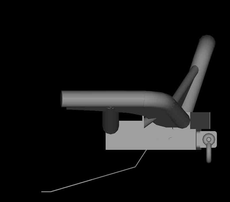

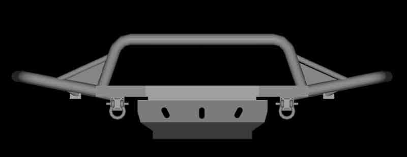

I am going to be redoing the front and back of my runner. I considered building a bumber much like an ARB, but I kinda like the look of the tin foil crome bumber. A came up with a design that will be made out of the same materials as my rocksliders, and would go in front of the bumber.
What do you guys think? Any possible problems?

Bottom

Front

Side

Here is a Photoshoped image of what it would look like

Oh my god.... I have to check my pants after that!
That bumper looks so awesome! The only thing I with was it came up a little higher on the truck, but dang! Way to combine prerunnerish styling with toughtruck styling.
If you made this, would you consider selling some, or selling the designs? What does it bolt to or weld to? Also, is it intended to go infront of the original bumper, or take that off as well? I think if it was higher, that it would look better if the original bumper was off and then mount the turn signals inside the main loop bar (in front of the grill). Otherwise, it looks good with the bumper on at that height.

I am planning on leaving the front bumper on, for now. I have designed it to bolt on to the front frame so if for some reason I need to take it off I can easily.

That does look really great!
First question, what is your new skid plate attaching to? Does it go all the way back to the stock mounting spots and are you going to bolt it on just like the stock plate?
Second question, what program did you use to render it? I-DEAS 10? I have finished rendering my new bumper on I-DEAS 10 and I plan to start building it tomorrow. I will get a screen shot to see what you think. Looks like you have some design and fabrication background.
Nice work!

I haven't decided exactly where I am going to mount the skid plate. I think that part I am going to decide after the rest is built. I used AutoCAD to do the drawings. If you want to post a screen capture I would like to look at it.
