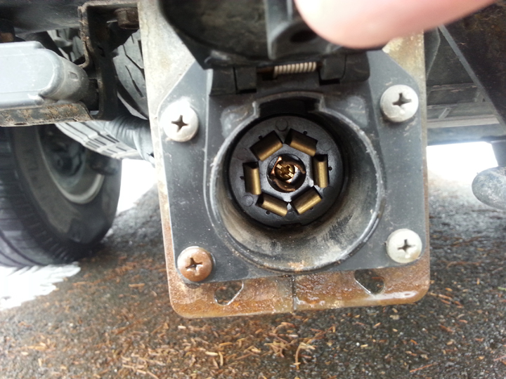

My girlfriend and I are debating towing a light trailer (2500lbs dry) to AK from California. I got a lot of good advice on here from many replies. Thanks!
One of the things I would definitely do would be to get EBC. I know nothing about it, but I noticed on a "how to install EBC system" thread that you need a 7-pin connection. My 4runner has a connection on the back for 6 pin? that I use for towing a small boat trailer.. so my question is does that mean it would be cheaper to do the install than without it? Is the wiring already there?
About how much should I expect someone to charge me for the EBC installation? It isn't the type of work I can do on my own...at least I think.
Thanks!!!!!!!!!

The type of connector plug that you have should be suitable for electric brake use.
I cannot speak to the expense or difficulty of brake controller installation.
It is a common installation, so it should'nt be too expensive.
The U-Haul shops likely do these installs, but I'd shop around for pricing, for sure.

I agree with millball. Looks to me like you have a 7-pin connector. 6 around the circle and one in the middle, just like my 7-pin connection.
Seems like the wiring should all be there, you just need to find the other end of it to plug into the brake controller.
I installed all of it an my Tacoma, and it wasn't really a big deal. I just bought the controller and a kit that came with the wiring harness, connectors and the 7-pin plug.
Rather than tying into the brake hydraulics, it ties into the wire connected to your brake lights, if I remember right. The one that's right up against the actual brake pedal, which gets activated when you step on the brake, sending a signal to the brake lights.

The good old days when you installed the Tee at the Master cylinder does indeed bring back memories.
I use 7 pin plugs for everything most without brake controllers .
So unless the brake control unit was removed good chance the wiring might not be there.
It is just a good splice into the brake switch wire a wire from the control to your center pin on the 7 pin plug
Depending on the control another wire to ground
