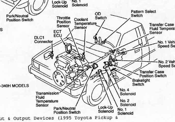

Here's a pic of the location of the solenoids. It seems that if there is any kind of possible trans problem, I've had it.
