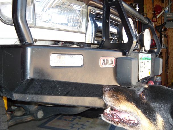

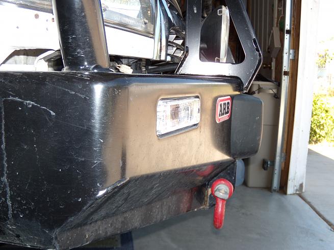

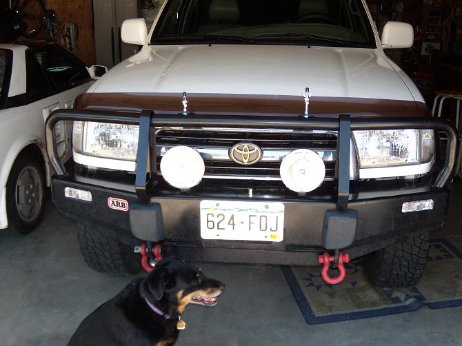

pics of a great new look
pics of installed lenses. Note how the dog shoves her mug into each photo.
Just as when I open the back end of the truck she assumes it is all about her going to the mountains- now she assumes each time the camera comes out it is for her picture so she poses for me. Just like a dame...which she is...

Nicely done sir. I think your dog may be a better (smarter) assistant than some I've had... and if a knack for encroaching photos is the worst quality she exhibits, you're a lucky man.
