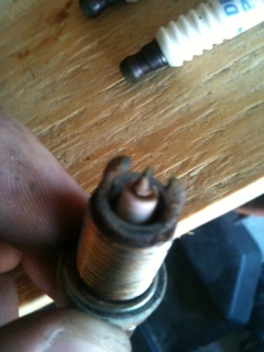

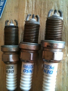

Old Jul 20, 2011 | 02:10 PM
  #32
josh.bunch's Avatar
Joined: Jul 2011
Posts: 2
Just changed mine last weekend for the first time in over 130K and they didn't look that bad.
Or that good.

Actually they do look real bad, look at those gaps!
Well, they look pretty good for 130K! Seriously, those were toast a long time ago.
Yeah, for 130k i guess they could be worse although not sure how much worse.
Bet that truck drives like new after that change!

OMG, those are toast.
