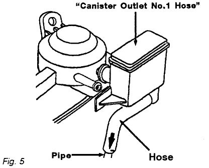

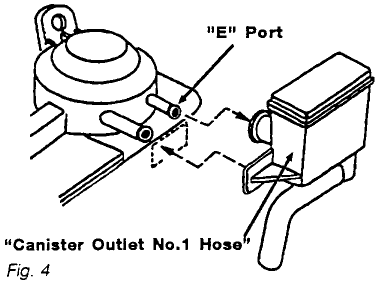

The fix for this is very simple. It involves installing a small chamber on the forward most nipple of the EVAP canister.
Reference TSB EG002-97
Order part number 77701-35010 from the dealer. It is just a few bucks.
Install it like this:
Now your buzz will be gone for good.
