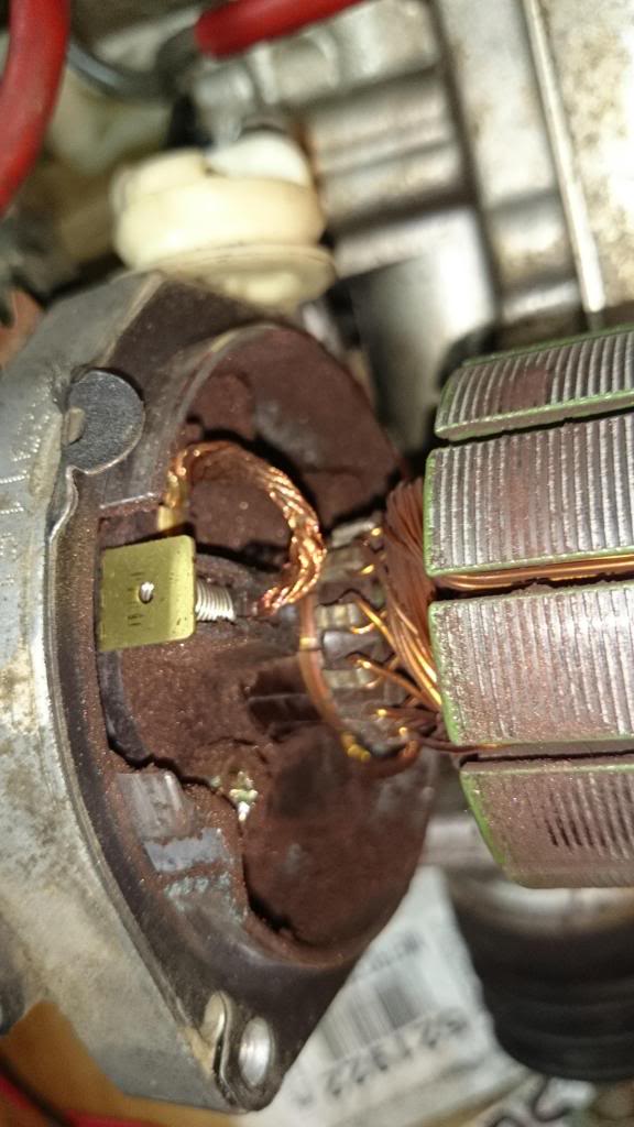

Well I think I found the culprit.
Took off the cover off the pump motor, and found a really fine brown dust covering everything. It looks like normal wear and tear from the brushes. Seems like too much though for 250000km (155000 miles).

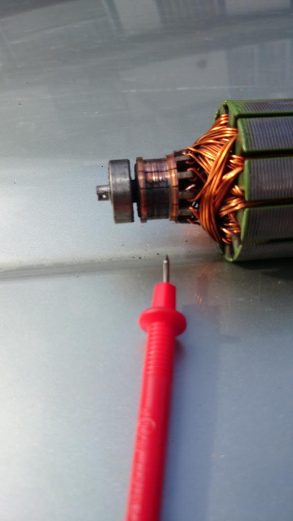

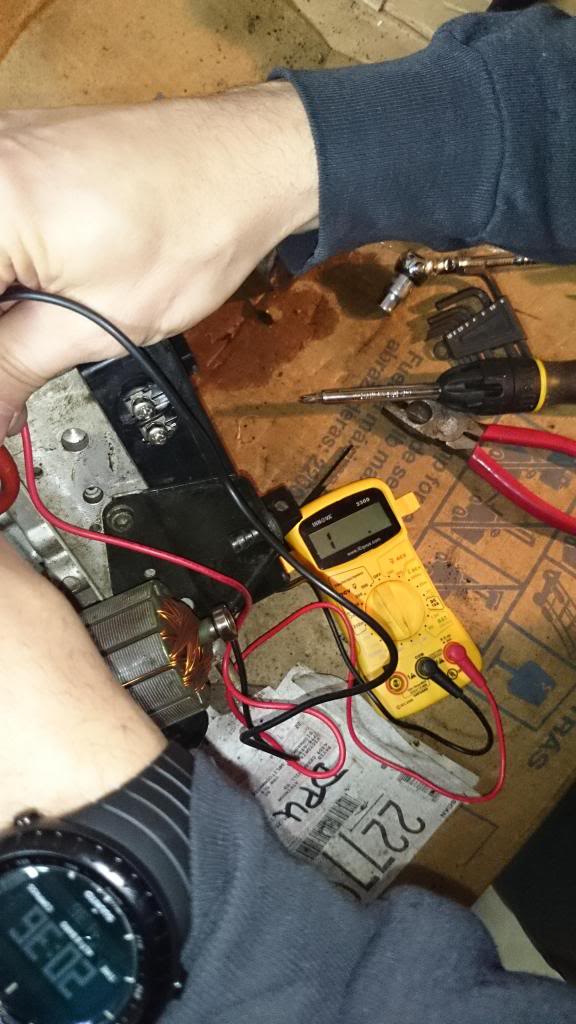

Using a multimeter on the electrical connections to the pump, I could get a short just by moving the probes around a little.

We used a vacuum with a straw attached and some compressed air to get the dust out.
After getting all the dust out, I couldn't get a short no matter how much I moved the multimeter probes around. I'm convinced it was the cause. Hooked it up straight to the battery aftewards and it works. Putting it back in this weekend.

Well the problem came back after a couple of weeks, so it was time to dig a little deeper.
This time I took apart the pump itself.
On the part of the pump that the multimeter probe is pointing to, you can see some of the copper coating has worn off. That was the problem all along, and it explains intermittent operation that some other people have experienced.
After the motor stops spinning, if one of the brushes ends up on this dead area, the motor won't be able to start up again. Sometimes I think it will get jolted back into place and can fire up again. The problem wasn't continuity, it was lack of continuity.
I have no idea how to fix this. Might be time to throw in the towel and go to the wreckers.
