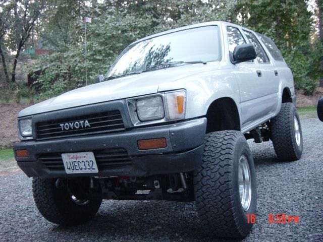

we just finished installing some 35s on my wife's 90 Runner,12.5x35x15 BFG ATs, on 15x10 Ultras, they fit good, just a little fender/tire contact at the back of the front wheelwell at a hard turn ,,we have a 4" Pro-Comp lift,,
pic is when we had some 33s on it, !
