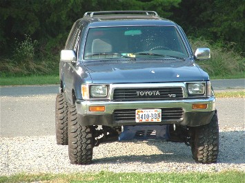

Alot say 15x8's but if I had my choice with 12.50's I would go 15x10's. Get the right amount of backspacing too! Heres some shots of my 31x11.50's I just took

the sx is more hardcore they wear real fast...I'd go with LTBs if price is your issue wearing is about the same but they grip better and 34s fit real well on our trucks. The Trxxus is better on road then the SSR then the reg TSL and LTB.
Here's a couple pics of my truck with 34x10.5 LTBs
