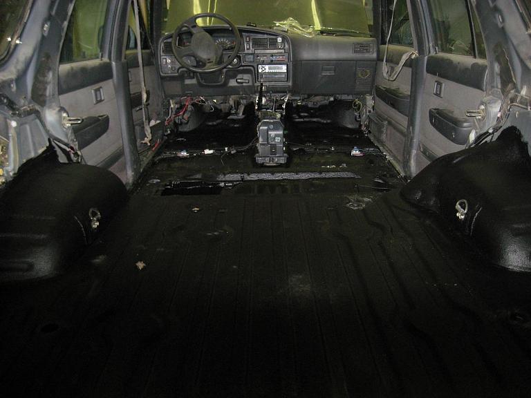

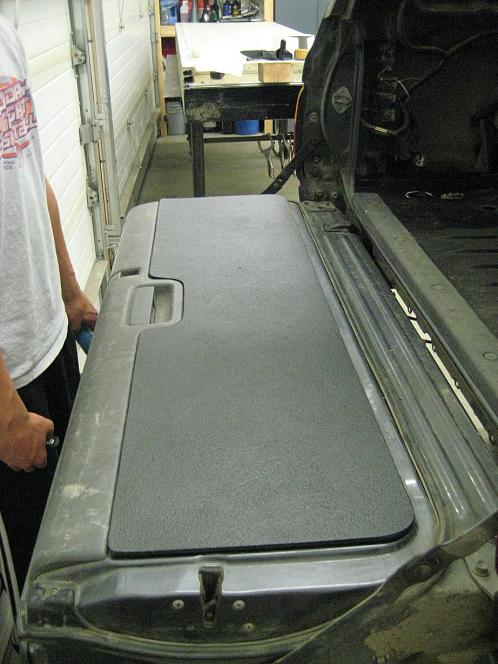

I did mine last summer after swamping it in a nasty mud hole. I just pulled everything out and made sure i prepped the metal really well. I think I used the Herculiner product. The only place I am finding it to be peeling off is on the tailgate. I stripped the carpet off and sheeted the wood with some sheet metal. Just normal loading and unloading junk has taken its toll.
