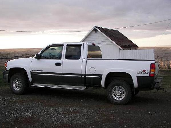

Here is a picture of my White GMC Sierra that has the rocker panels coated. I like the looks of it.
Also, i'm building a new bumper for my 91 pickup, I was thinking about putting Herculiner on it, does anyone see any issues with that? I figure it would be more durable than paint or powder coating. Thanks.

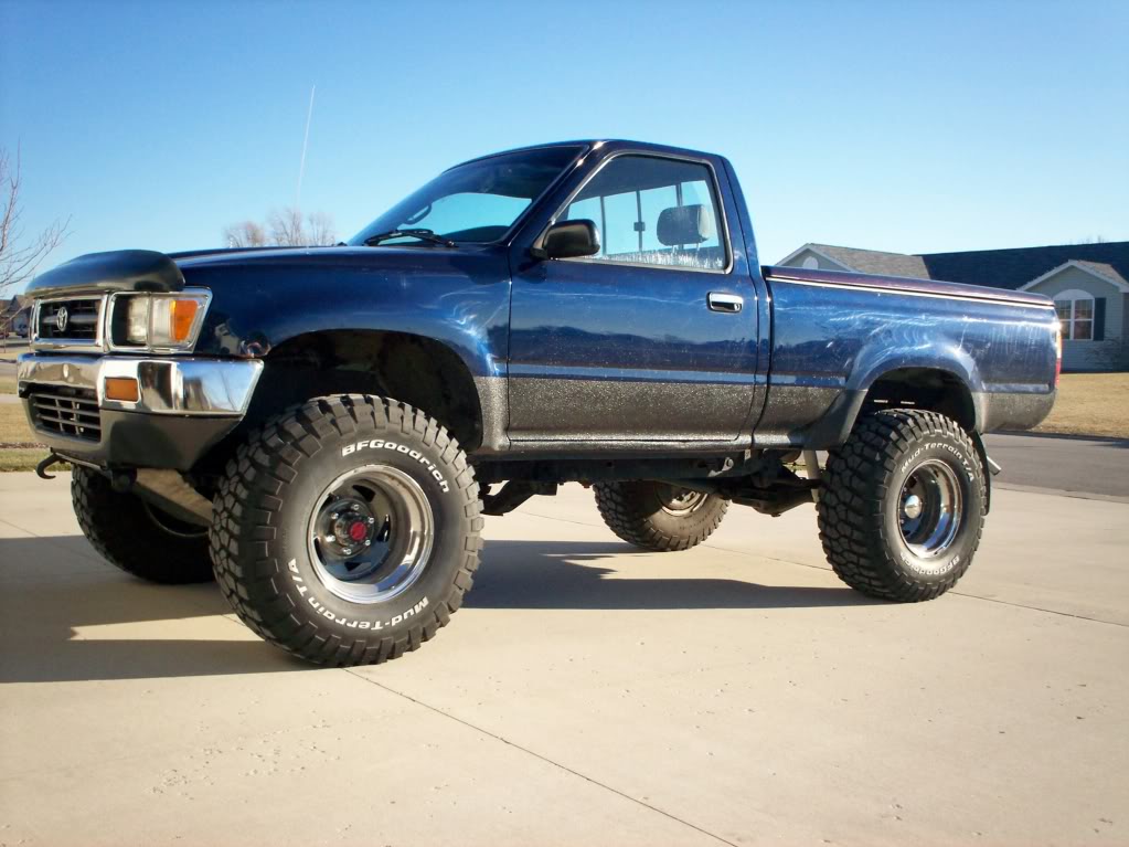

i know its beens awhile,but i went ahead and did mine,big tires = big rock chips. i think it turned out really good with the color .Name:  000_0617.jpg

yep,make sure you stir the hell out of it...i used a foam roller.

yep,herculiner, make sure you stir the hell out of it even as your going...i just used a foam rollar and plastic tape for a really fine line.
