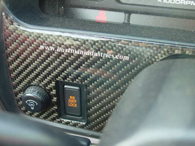

Look to the left of the steering wheel column. There will be a button w/ red letters saying
RR
DIFF
LOCK
If the button isn't there, then it doesn't have a locker.

Look for a button to the left of the steering wheel that says RR DIFF LOCK.

Even more sure than looking for the switch, look at the diff. If the drain is on the drivers side, it has a factory locker. If the drain is on the passenger side, it does not.
RR
DIFF
LOCK
Old Aug 18, 2004 | 08:54 AM
PoBoy's Avatar
Joined: Dec 2002
Posts: 1,998
From: Phoenix, AZ
I knew it was orange writing!!

Haha...I thought I was color blind till Jason posted the pic and I showed the wifey ...hence I was so happy to know it was orange
