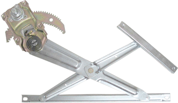

Just wondering, Is there a way to test the window regulator and get a definite result to know that is what is going bad?
And also to clarify, the regulator is the motor not the mechanism that raises and lowers the window? correct...
Thanks...
Nope. Regulator is the mechanism. Looks like this:
Basically, any point where two separate parts come together can fail. It could be something you can fake with a fastener, or something you can fix only with a new piece (more likely). As I said, you need to get in there in and look with the old Mark I eyeball--the old-fashioned approach.
