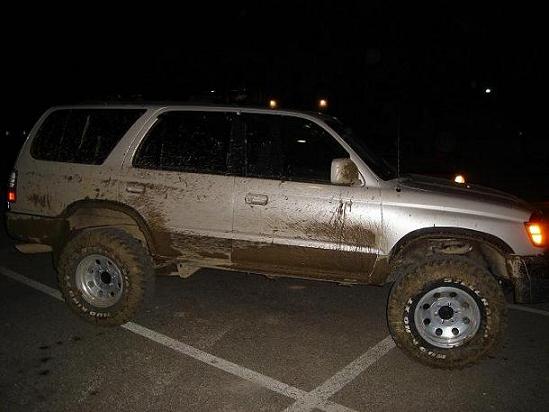

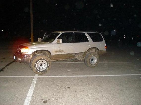

Oh and here is some pics of my whip if anyone wants to comment on it. I thank you guys for everything that you have found on the 4runners, because my 4runner would not be a bad-ass machine without you! Thanks...
