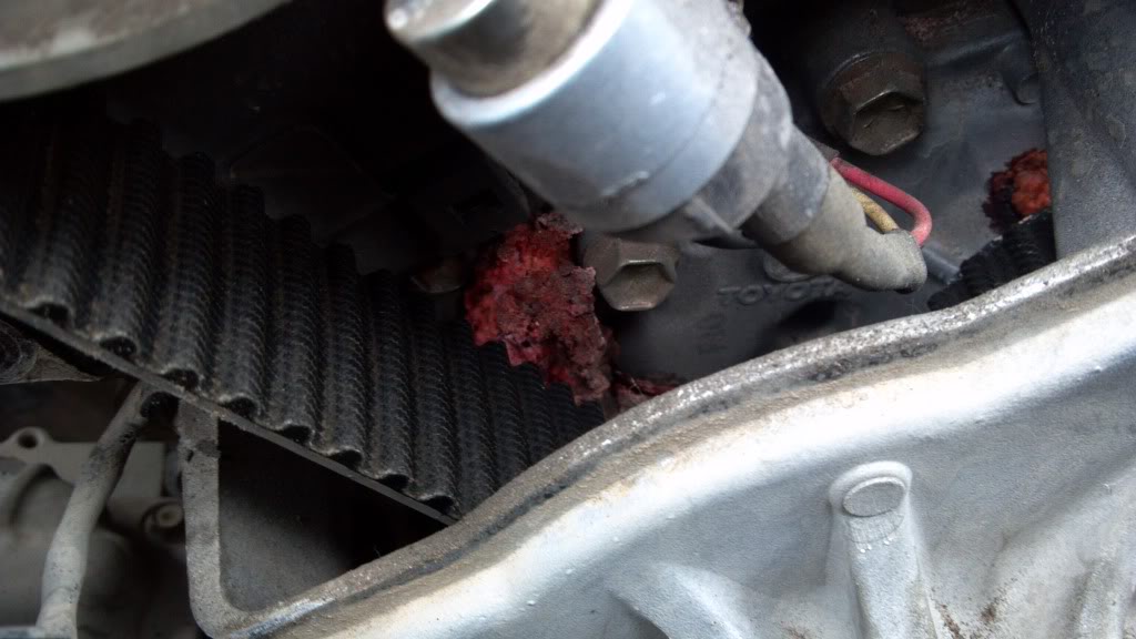

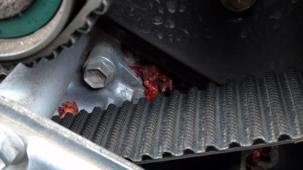

Pictures are of the water pump and the stalagmites I was growing.

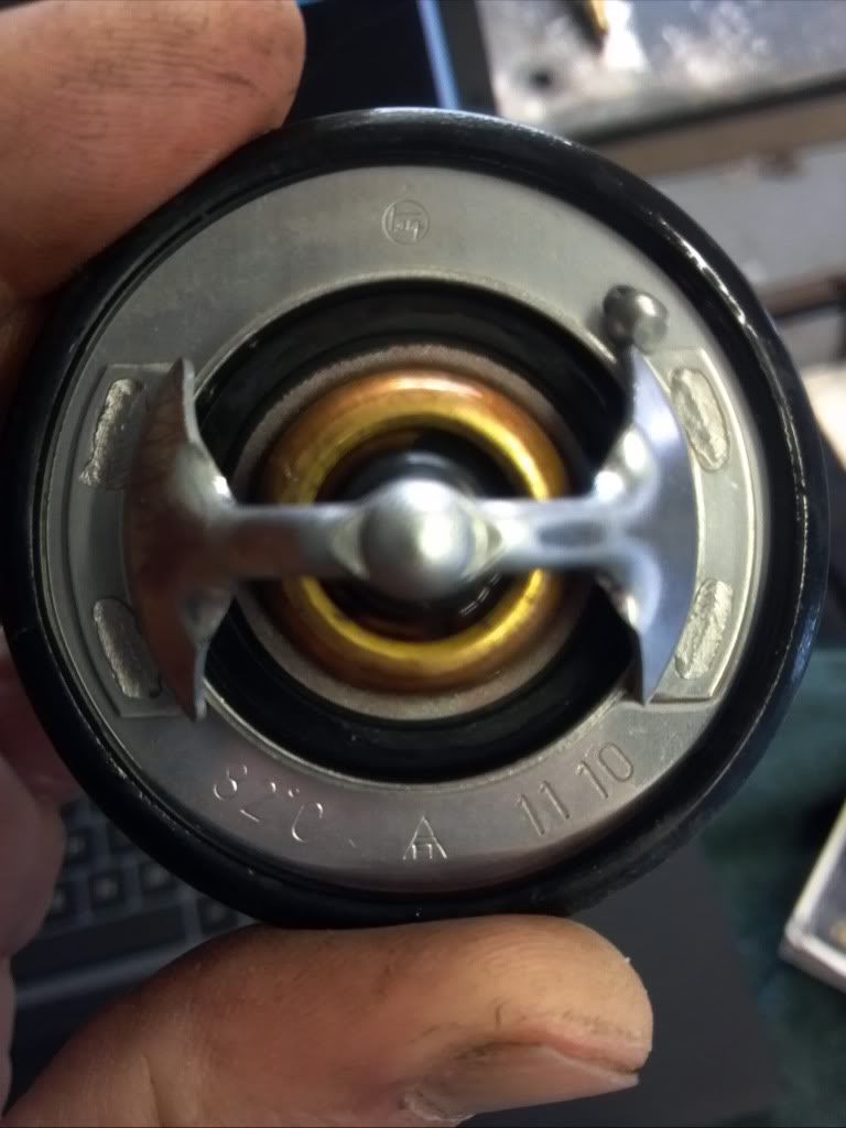

Ok the thermostat is correct. Now I'll go give the pot trick a shot. The jiggle valve being on top makes sense for the air to get out but the fact that the FSM says 6'oclock makes me a believer. I'll post the results of the tstat test. Thanks so far for the links and pictures guys.

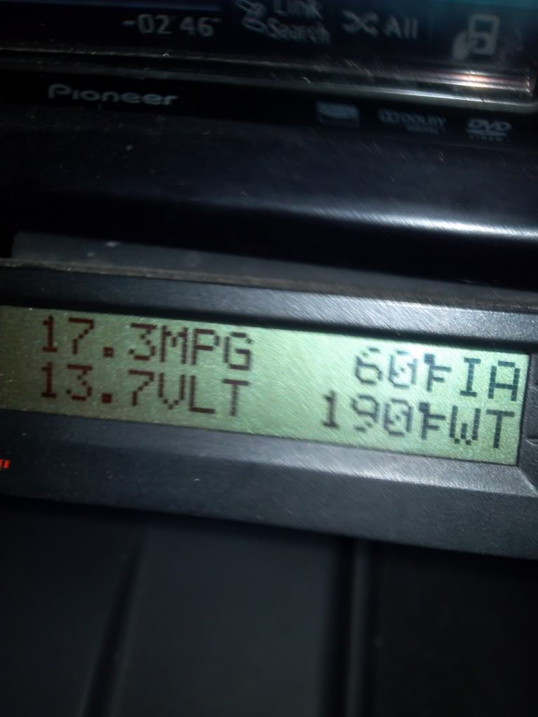

Ok guys. Good news! The thermostat test ok, it was: 180° closed 190° closed 195° opening 200° open. I tried installing it in the truck (jiggle at 6'oclock), I filled the radiator and left the cap off as the truck ran. I made sure to really work the top hose and have a half full funnel in the fill neck at all times (I saw a lot of bubble come out). After a 20 mi. drive the truck never went over 190°. Thank you Thank you Thank you! I'm not sure if it was an air lock issue or the jiggle but its running great.
Old 02-18-2012, 06:46 PM

Excellent! Bubble, jiggle valve, whatever......good you are back to normal! This is not the first time the changing the jiggle valve to the 6:00 position seemed to cure the issue. Crazy, huh?
