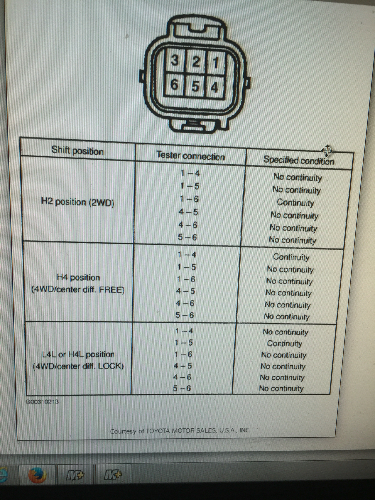

Old Nov 25, 2015 | 04:48 AM
  #416
Adkins's Avatar
Joined: Nov 2015
Posts: 8
This is what I used to determine the position of my actuator. I was in h4L but the actuator was reading h2. Hope it helps.
Old Nov 25, 2015 | 08:17 AM
  #417
Cmayer's Avatar
Joined: Jan 2011
Posts: 135
From: Murrieta, CA
Originally Posted by Adkins
Attachment 103336
Thanks! That's a big help. I'll check that connector with an ohm meter tonight.

Old Dec 7, 2015 | 10:57 AM
  #419
Cmayer's Avatar
Joined: Jan 2011
Posts: 135
From: Murrieta, CA
Attachment 103336
So using this, I was able to determine that the actuator indeed goes to all positions. However, when in any 4wd position, the indicator light just flashes.
Another question to those that have moved the actuator by applying power directly to it...does it always engage / disengage smoothly?
Sometimes I can hear the actuator move, but rather than clunk into place, it just binds and groans at the end. I have to move it back and forth reversing polarity a bunch until I get lucky and it pops into place with a loud bang.
I'm wondering if something is bent inside the case and causing all these issues. I did accidentally hit it with 10 amps instead of 2 amps once and it moved faster, but I can't image that damaged anything; hope not.
