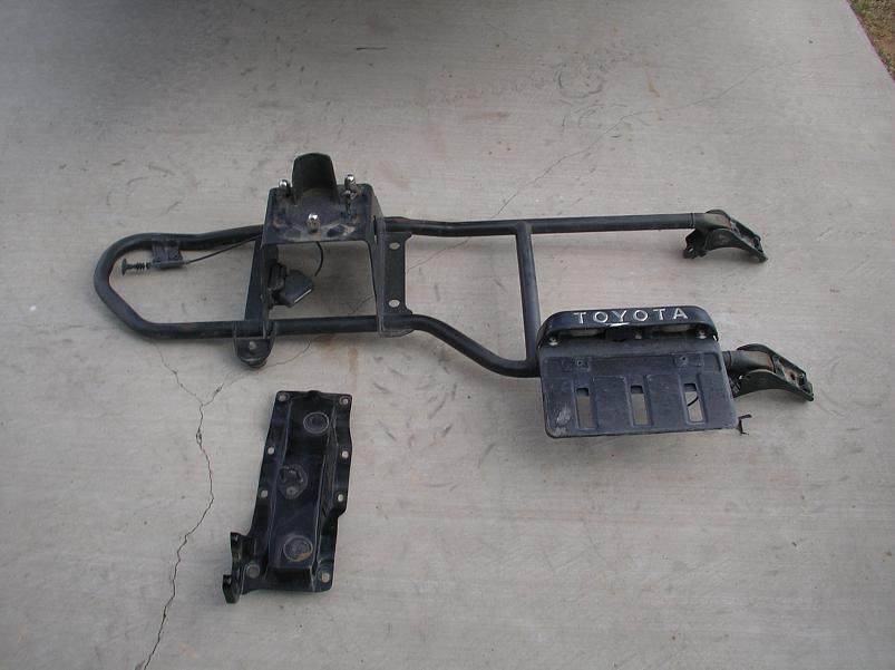

4Runner spare tire swing out Day 1
Well here I go. I just picked up this early 90's 4Runner spare tire swing out at a local salvage yard on 8 March 09. A few rust spots but works like new. 9 March 09 removed rust and painted swing out. Its going to be a work in progress. Next step. Get some metal/bolts for some reinforcement. Will add photos as it goes.
Attached Thumbnails 4Runner swing out tire carrier? Can it be attached to a Tacoma?-pre-tire-swing-out.jpg   4Runner swing out tire carrier? Can it be attached to a Tacoma?-just-back-junk-yard-8march09.jpg   4Runner swing out tire carrier? Can it be attached to a Tacoma?-sizing-up.jpg
Cool to see you took the plunge I will be watching to see how it go's looks like it will be fine as for the centering issue drop it a inch or two to get around the tail light and it should look factory can't wait to see it done
