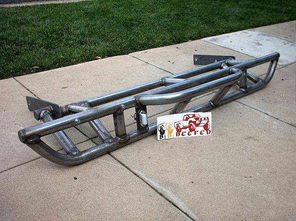

Thanks for the positive comments guys. My plan is to make a jig from this bumper for the future. It bolts into the stock holes on the lower portion of the frame, (4 per side) and then I used a factory hole in each side of the frame for the front brackets. I slipped a 1/2 bit into the factory hole and drilled the inside of the frame which allowed me to slip a 1/2" grade 8 bolt horizontally through the frame toward the front of the bumper. A very easy bolt on procedure.
This is a 3rd gen 4R, and I'd really like to know if any of you know if this bumper will fit on any other generation 4R's...? My goal is to offer something for the future because it doesn't seem like many companies offer much for the 4R.

That will only bolt onto 96-02 4Runners. Good work man. Best of luck with the sales.

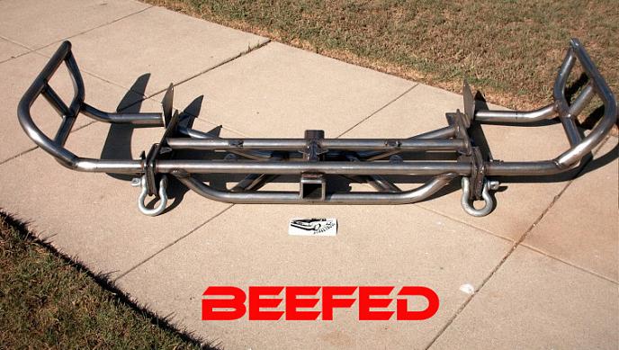

Did you take your camera? Travis I'm still interested in building that jig when we find the time. I'd like to offer a few styles ranging from yours down to some simpler designs that would be a bit more affordable, as options are always good. Ranging from about $225 up to $650 or so. Here are a couple I did for the Tacoma, the non wraparound is $259 +shipping. He paid $79 to have it shipped UPS ground from CA to NY. Custom fab shipped right to your door.
