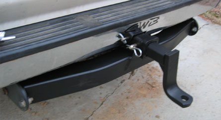

Just a little thought on the hitch problem. Not sure if your hitch is like mine, but i just did a mod today to really help my hitch get out of the way. I'll do a writeup soon, but here is a pic of what I did. I like your idea, not sold on its worth as it wouldn't save THAT much under the hitch. Plus, after all is said and done... how much more would a custom bumper be? I like the idea though.

Then there is the bull bar vs brush guard argument. If infact it does fail, would it do more dammage than if it wasn't there at all? Just a thought... constructive critisim...

Turboale-My hitch is welded so I can't do that. And, I would make it out of material strong enough to act as a rear bumper, not a light weight brush guard. And I am sure I can do it for about $100. I only have about $100 in my sliderz and this would require less material.

I'm definately with you on the roll pan thing. The sawzaw cut through it like paper. Ive also got a nice dent the size of a couple fists from this mud hole . I could probably bang it out, just haven't even thought about it. I want a tire carrier, so eventually i'll probably end up with a custom bumper if someone doesn't figure out how to make them cheaper than $1k. I'm also not too fond of the chrome either. Ive got a tjm, and rock crawlers, and hopefully some sliders soon, a nice black bumper would just look right at home

I like your idea of flipping the hitch upside down.
