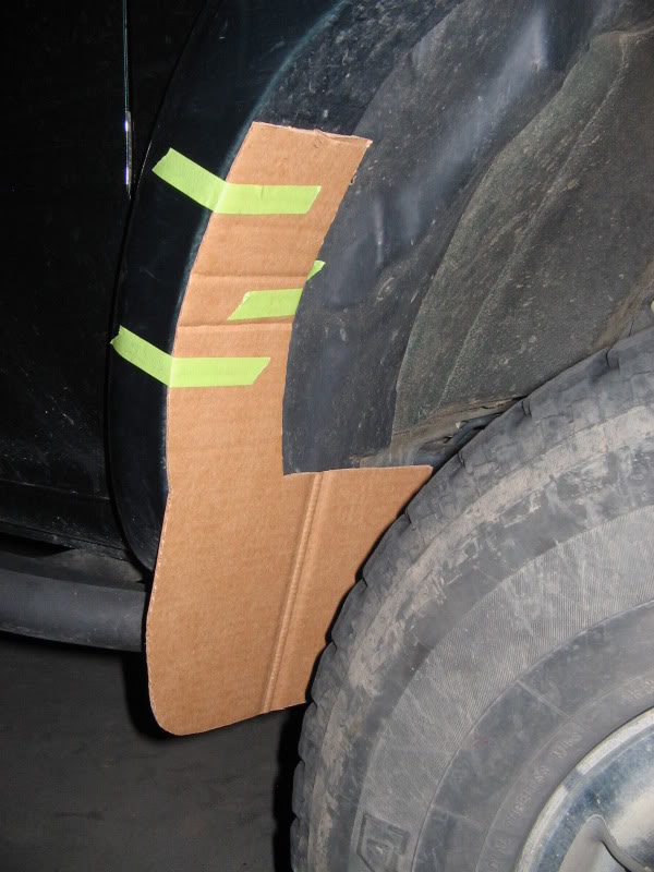

Started on a template for the front mud flaps. Still needs a little tweaking. I'm going to take out that curve on the right and just run it straight like others have done but I wanted to see what it would look like and probable do a little trimming for some plastic pieces underneath for a cleaner fit. For the curve on the bottom I just made a template of the rear mudflaps and used that for these.

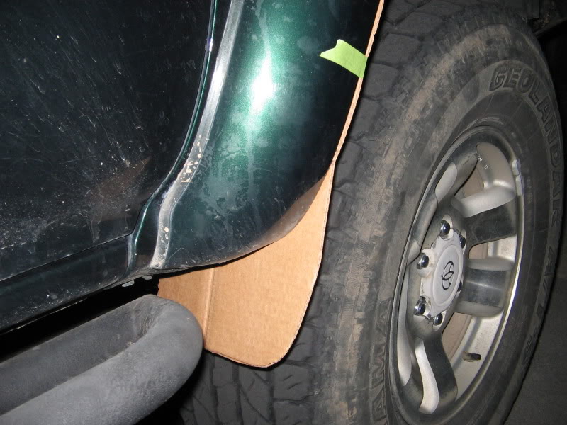

Need to do some trimming on the inside but it still gives a me a good idea.
Once I get everything trimmed up right I'll transfer to some 1/8" plastic I picked up from a friend then mount them.
