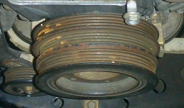

    Yeah, before I tackled the timing belt, I read up on the 3.4L engines being non-interference.
    The main crank pulley is about 90 degrees counter clockwise from 0 TDC.
    I attached a picture to show how far it's off.
    I'm including another picture of the belt. I don't feel like doing this routine again, so I'll replace it with a new belt. Notice the teeth marks on the backside. Up close, it looks like melted rubber patches like race tires.
    Also to be on the safe side, I'm going to replace the idler pulley #2.
    Apparently the dealership doesn't sell the o-ring for the pulley.
    You can see the dried coolant drops near the bearings in the pulley.
    I'll probably go the salvage yard for a idler pulley since the dealer wants $94.
    Attached Thumbnails 3.4L 99 4Runner: cranking, but not starting.-main_crank_position.jpg   3.4L 99 4Runner: cranking, but not starting.-timingbelt_idler2_condition.jpg

    I'd say that was definately your issue, no way it will fire up when that far off. I am curious to see what the crank looks like when you get the crank pulley off. I really would change the tensioner and idler on there especially after seeing the belt burnt like that (that's the first time I have ever seen a timing belt look like that....and it was still intact).
