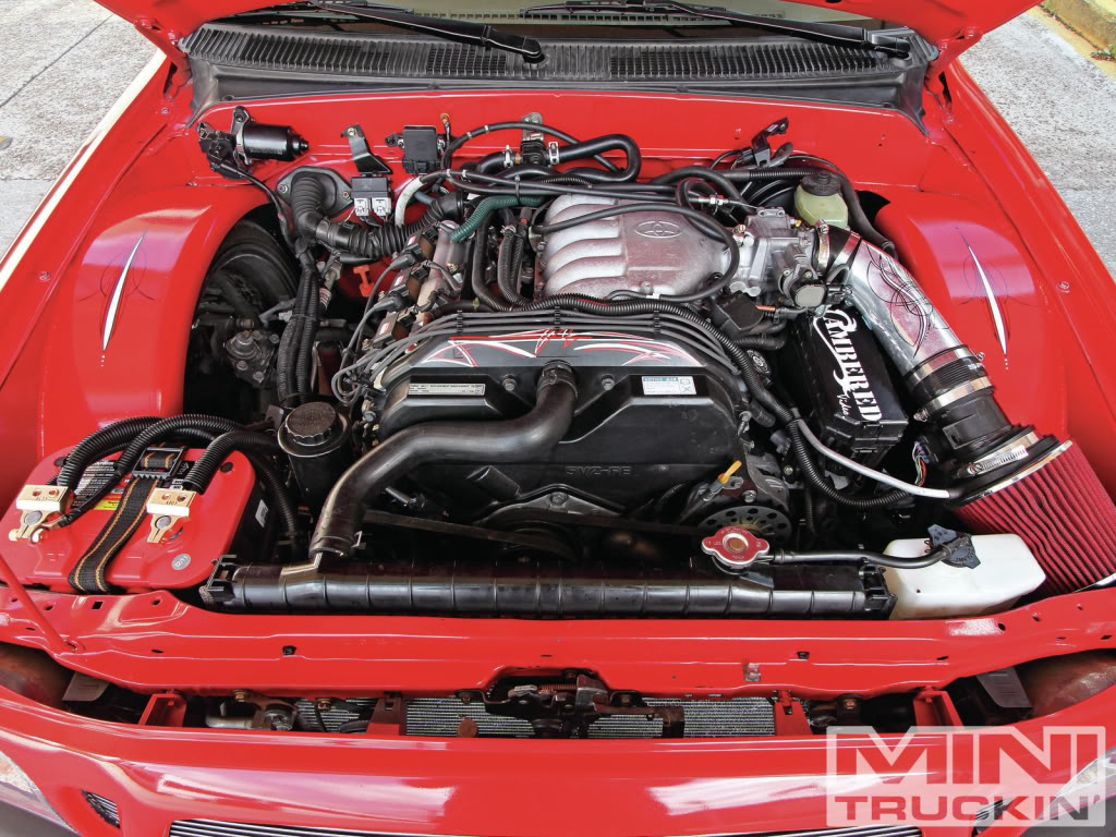

Is this the one you are talking about?
http://www.minitruckinweb.com/featur...is_wheels.html
If so, that changes my thinking. I thought you were asking about rotating the entire upper and lower plenum to fit facing this way, which would require some machine work. However, the split portion between the upper and lower plenum use the same gasket, so I'm assuming that in theory, it would work. But again, it would be one of those things you could to just to set your truck out from everyone else's.
If you look at this link, they did the same on this 3.4 4runner. In the specs, they say they used an adapter to mount it this way for hood clearance for the body drop.
http://www.minitruckinweb.com/featur...unner_highway/

Maybe just to shorten the height of the engine...so they wouldn't have to alter the hood...the 3.4 is fairly tall.

yea it says it it to bring the height down 3 or so inches I believe if said , so I guess it really wouldn't do anything but look similar to the 3.slow lol it might slow the velocity of the air down with the shorter runner in the 2k and under range ??? maybe and thank you 250000 yota for posting that cause I couldn't

Ya I don't think there would be any real performance gain other than in the higher rpms, which isn't where the engine is designed to run anyways. They only did it for the clearance issues

Only reason I could see to do this would be to shorten the stupidly long factory runners. But personally this should only be done if you have boost, if you have boost then a replenumed manifold would make more sense and more power.
