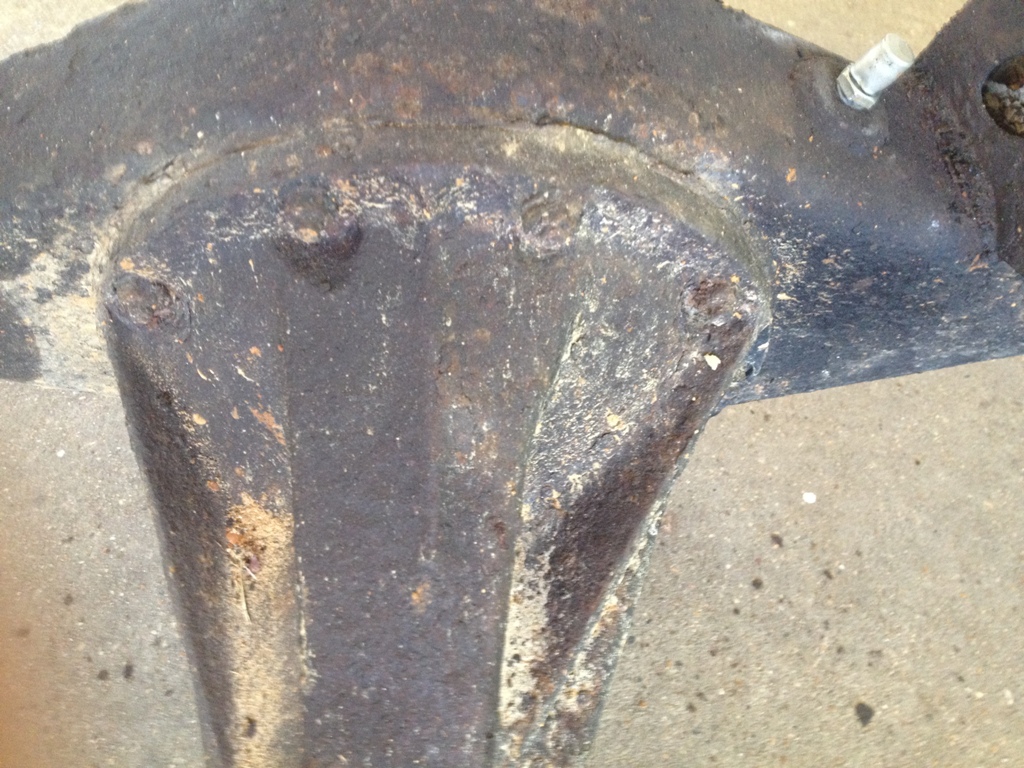

Step one was to remove the old axle assembly. Since I just did this to my parts truck, while on a trailer in about an hour the other day, I figured it was going to be a piece of cake. Not so. The rust on my axle complicated things a lot. I broke about half of the bolts off in the cable and brake line bracketry and completely broke off two of the brackets in the process. My rust damage was much worse than I thought it was. The control arm bolts were tough but I'm used to that kind of thing. Most days I'm working on old logging equipment and log trucks. The big lesson I learned was about the order in which you remove components. I have a 3" lift on my truck so I figured that the shocks could be removed easier after I got the load off the suspension so I saved them for last. The lower mount will absolutely not let go if everything is not in line so shocks come off first and go back on last. I ended up having to remove the top nuts which are a nightmare and not part of my plan.

Much more to come on this project. Any input or questions are more than welcome. Like I said, I'm posting this for the next guy that wants to try it. Here are some pics. Check out the rust on the old diff. I'm glad that thing is out of there.

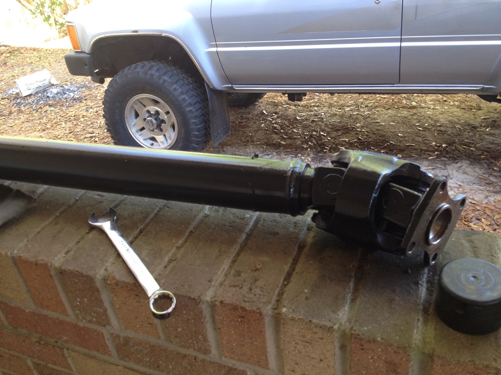

Next I installed, or better yet, tried to install the good looking drive shaft from my donor. I went over it thoroughly, sanded out any imperfections, did a quality paint job and greased it well before realizing that it was two inches longer than my original. Had to start that project all over.

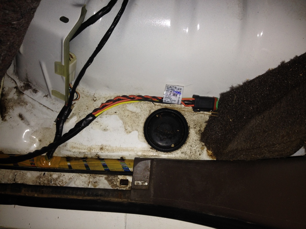

Today I finished the electrical end of the project. I took a brake from the project and really researched the wiring and found some great resources. I found a thread detailing a project like this that had multiple links to others' retrofit projects and wiring diagrams. After looking at four or five of them, I decided to use a DPDT relay to shift the locker. Today after realizing that all of the Radio Shacks in this part of the world had gone out of business, I got impatient and decided to go with a different diagram which used the factory diff lock ecu. I took my time and followed the schematic. A few hours later I had my harnesses built and had it working. Actually got it the first time. This was the diagram I used. http://www.toyota-4runner.org/3rd-ge...ml#post1038490
I am not much of a solderer so I used deutsche connectors and built a harness to run down the door jam which included five wires. I tied my two ground wires from the locker together and grounded them in the rear of the vehicle. I then made a pigtail off of the ecu connector with two 6 pin connectors. I put the five wires from the back in one of them and put my three grounded wires and two power wires in the other for a total of 10 wires.
For the switch, I used an inline safety switch that will require me to turn it on before pressing the factory button. This safety switch has a bright blue light in it that requires a ground wire to light it up. I ran the diff lock indicator light wire (which is a ground signal) to the ground pin on the safety switch. Now, when I shift the locker, i see the blue light in the safety switch blink until it's locked and then a solid light until I turn it off.
All in all, it was a pretty tough project but I'd say it went pretty well for me. Not I've got to swap out my front diff and I'll be done. I think I'll take a break for a week or so. I'm about burned out. I've also got to find me a new 4WD button/knob. I almost forgot that mine was bad and I had been using the diff lock switch in it's place. If anybody has one laying around, please let me know.
