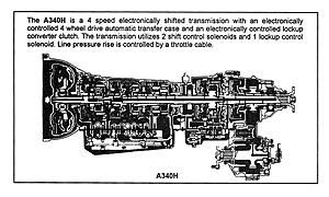

are you all taking crazy pills ? this is an aisin 340 series tranny, transfer cases
are side-mounted, and center shaft of tranny drive rear wheels. front power
is tapped with a chain driven transfer case
see this pic ? that is what is under that 4runner
the main shaft inside the transmission powers the main propeller,
which is the center driveshaft to the 3rd member to power rear wheels only
the tranny has a big hole in the side, that drives a big chain, and
bolted to this hole is the transfer case and this chain runs inside the
transfer case that runs the front propeller only
you have to be in neutral to shift from 4hi to 4lo, you do not have
to be in neutral to use the transfer case whatsoever
...it is shift on the
fly into and out of 4wd
summary
engine crankshaft powers torque converter/clutch and center shaft of
transmission
main shaft in transmission ends up going to rear wheels ONLY
a bolt-on piece, the transfer case, has a big ol chain running
into the tranny to tap power from the primary shaft in the transmission,
to run it's driveshaft, which goes to the front wheels only
transfer case is engaged or disengaged on-the-fly in any gear
only 4hi to 4lo needs to be in neutral to shift, and this doesn't
involve the transfer case one bit...this involves the low gear
in the transmission, transfer case has no gears, it only has enough
parts to move power from chain to the front driveshaft
you 'no move forward', transfer case has nothing to do with it
unless the rear driveshaft is disconnected and the vehicle is front-drive only

Please stop posting fasle information.
If you put the T-case in neutral then you will NOT get power to any wheels.
And it has 2 driveshafts coming out of it, one in the front off to the side for the front wheels and one in the back in the middle for the rear wheels.
