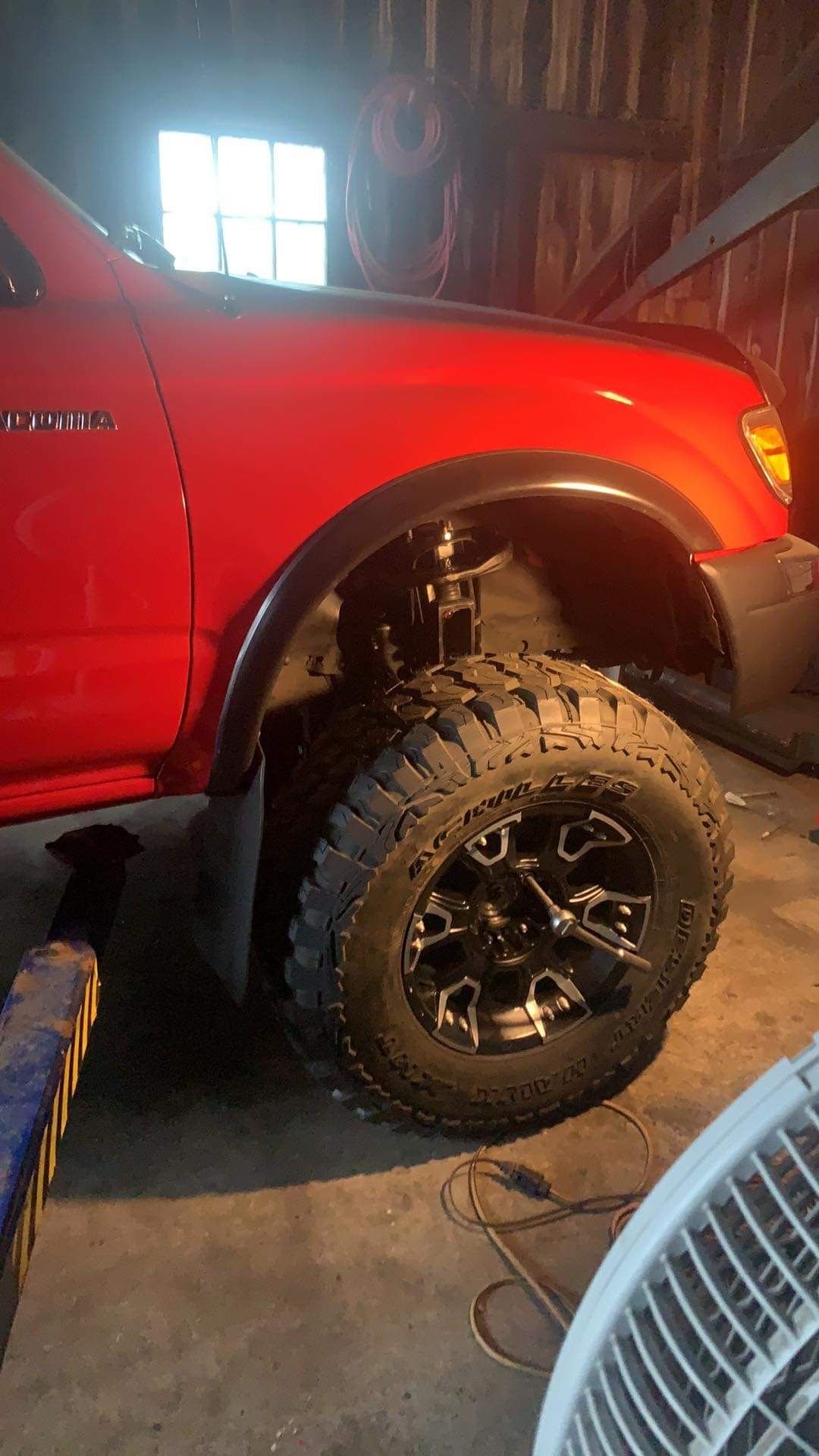

Good morning. Just installed a rough country 6” lift kit on my 2000 Tacoma. Running 305/70,17 rims. This kit uses upper ball joint extensions. After fitting tires the Tire’s rubbed those extensions slightly. Called rough country and they said to do the alignment first. I told them that won’t correct that space on top. I wound up trimming the edge slightly to gain the clearance. Anyone else had this problem?
