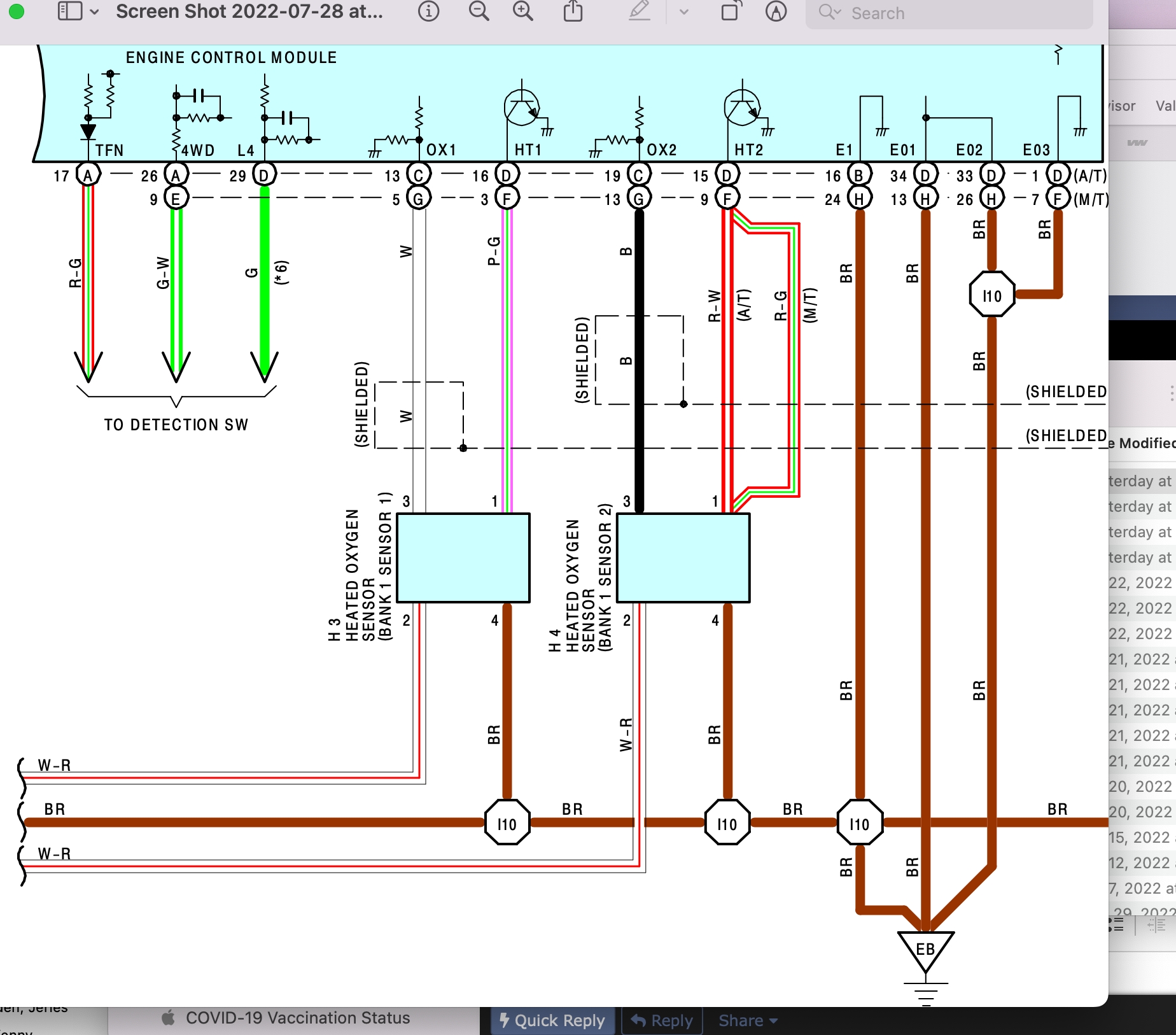

Here's the circuit, you can see Ht1 and HT2 go through the O2 sensor and then grounded at EB which means engine block. There is only one engine block ground, on the Tacoma its right next to the diag port on the intake, driver side. I assume 4R 5VZE is the same. Physically check that ground point - a lot of times when work is done on the truck people forget to attach that or its loose and I have heard that will cause a PO134.
Really difficult to believe its not a ground issue since the O2 sensors have independent heating circuits and the chance of a wiring problem on both is small unless the harness touched the exhaust or got mangled somehow but I assume you would have noticed this when changing the sensors. It looks like the wires go directly to the ground point, I believe its that wire harness that goes over the top of the transmission and near the driver side exhaust manifold and I think sort of turns back to the fire wall and joins the engine harness. I have also cringed a bit at the wiring harness so close to the exhaust manifold but it does seem to have some heat shielding on it.
I think the leaving the scanner on and codes do not appear is a red herring but not sure.

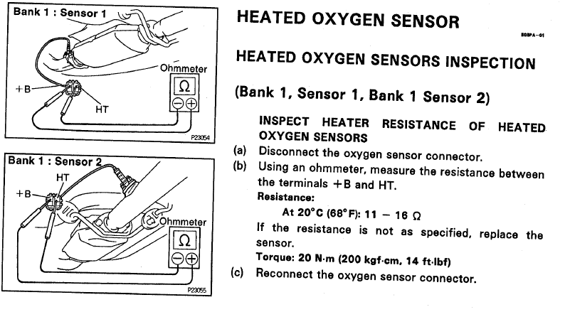

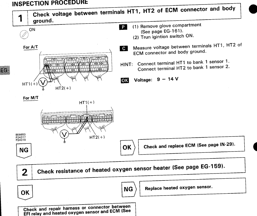

Here is the test procedure from the FSM for checking voltage at the ECM and the O2 sensor.
