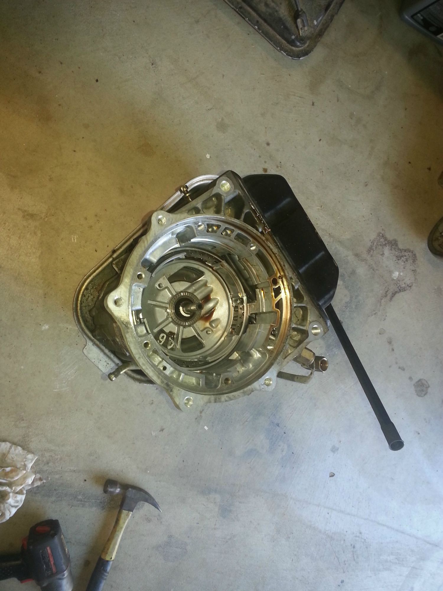

Bought a 2001 4Runner last year that had a 3.4 with a rod knock. I took a couple months to swap in a 1UZ from a '91 LS400, as well as Tundra front brakes, rear air bags and ARB front bumper. Thought I would share since I have gotten so much info from forums but never contributed.
I used the a341 transmission from the Lexus, which I disassembled to install the tailshaft from the 4Runner a340. I also used the deeper pan and shift shaft. Of course the TC bolted right up, but the rear driveshaft was shortened 2.5 and front lengthened.
