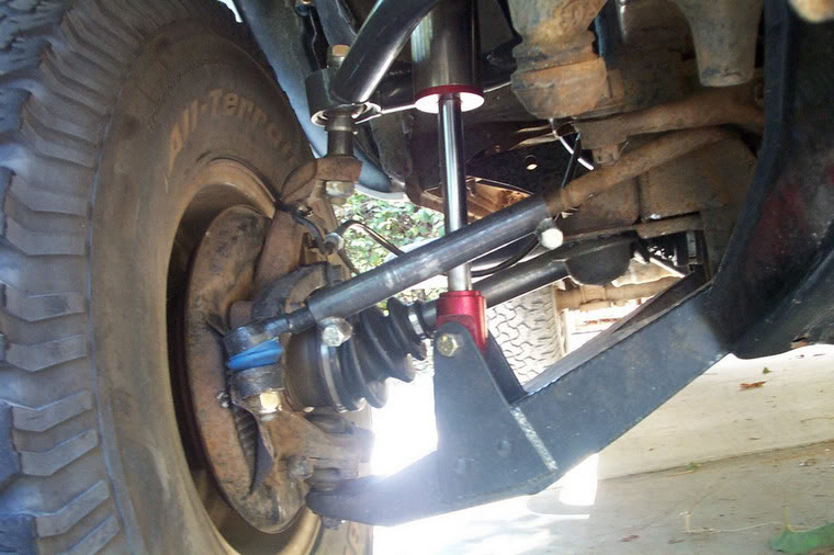

I think my project is similar to your goals, excepte for the SAS thing. Lots of guys run the rubicon with IFS. A built IFS should fair better. The front suspension kit I have will work on a 2nd gen, and it will greatly improve(Yes, I said improve) your street ride, especially if you install coilovers.
The cost is similar to a well built SAS. I wanted a vehichle that could perform as a competent daily driver, a little bit of high speed prerunning, and a good deal of trail crawling. Check out what BruceTS has done with a similarly built 3rd gen. If you want a strictly trail rider, I say go SAS, but otherwise check out the IFS options.
