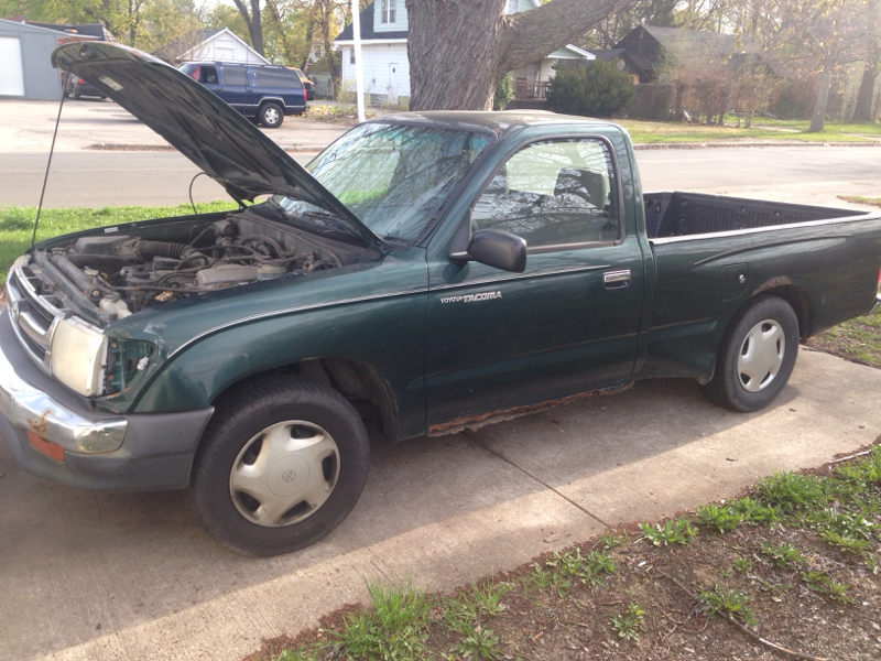

I wonder if lift kits or suspension kits exist for this truck. If not, I just bought a pointless little street truck.
Let me know what I can do to this thing guys!!!

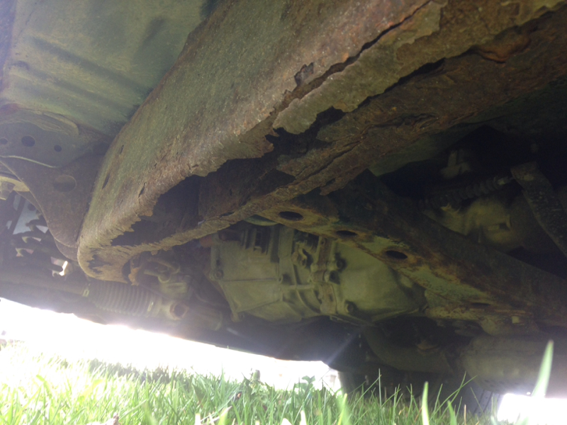

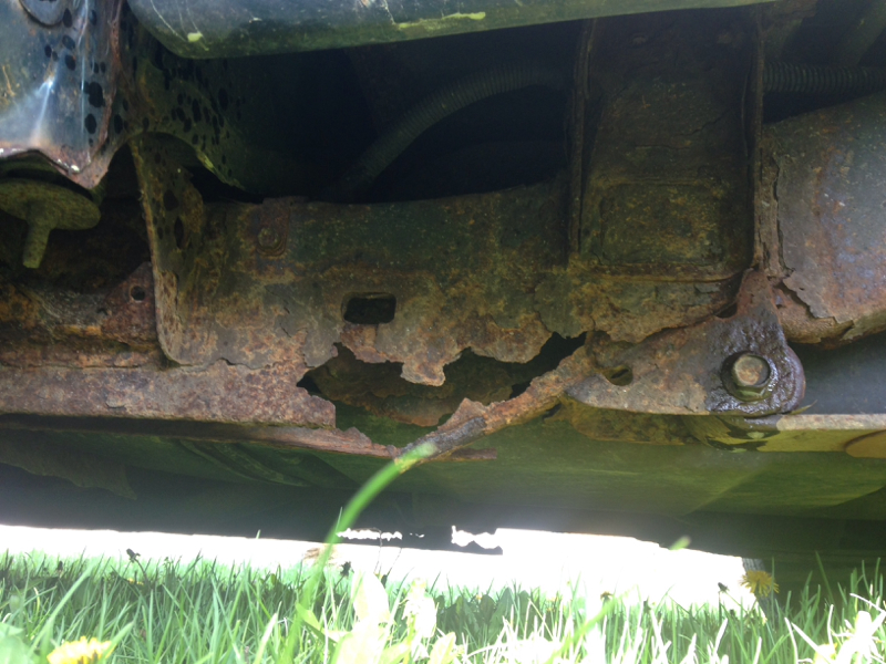

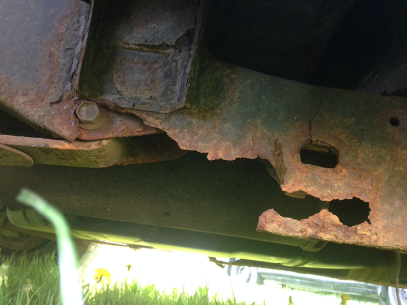

Ooh yes, definitely beyond being fixed. It's almost rusted in half. I'll see if I can get some pictures later.
Old 05-06-2015, 02:41 PM
bradwalma's Avatar
Join Date: Jul 2012
Location: Grand Rapids, MI
Posts: 10
Received 0 Likes on 0 Posts
Ouch!
Definitely doing a frame swap!
Attached Thumbnails 1999 Tacoma Frame swap-image-2898397733.jpg   1999 Tacoma Frame swap-image-261125514.jpg   1999 Tacoma Frame swap-image-3031318730.jpg   1999 Tacoma Frame swap-image-3977265230.jpg
