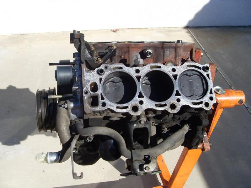

my 15 year old son and I yanked the motor and pulled it down. The good news it has two new cylinder heads, water pump, timing belt and both idlers on it. My guess is the previous owner overheated it and didn't realize the bottom end was hurt until 5,000 miles after the repair shop did the $2,500 top end job. Not wanting to sink anymore into it, they traded it in and cut their losses.
The worst of 3 scuffed pistons.

The bore
The short block
Considering how bad the piston looks, that bore shows very little evidence of the carnage. Even with two good heads, it may not be cost effective to fix. Good used motors are between $1,000 and $1,500 and I get to keep my current stuff as back up parts. I can rebuild my short block for about the same $1,000 plus another $500-700 to go thru the heads and make sure their right. If I rebuild mine, I should also update the knock sensor wires since they are a total pain to get to. If I could find some good used pistons, I might risk a $400 gasket set and $150 in head bolts to put it back together and see how long it lives.

Wow. Looks like oil starvation to the rings. Most likely due to the sludge bulid up.
My guess would be overheating/severe detonation caused the piston to swell and chew itself up.

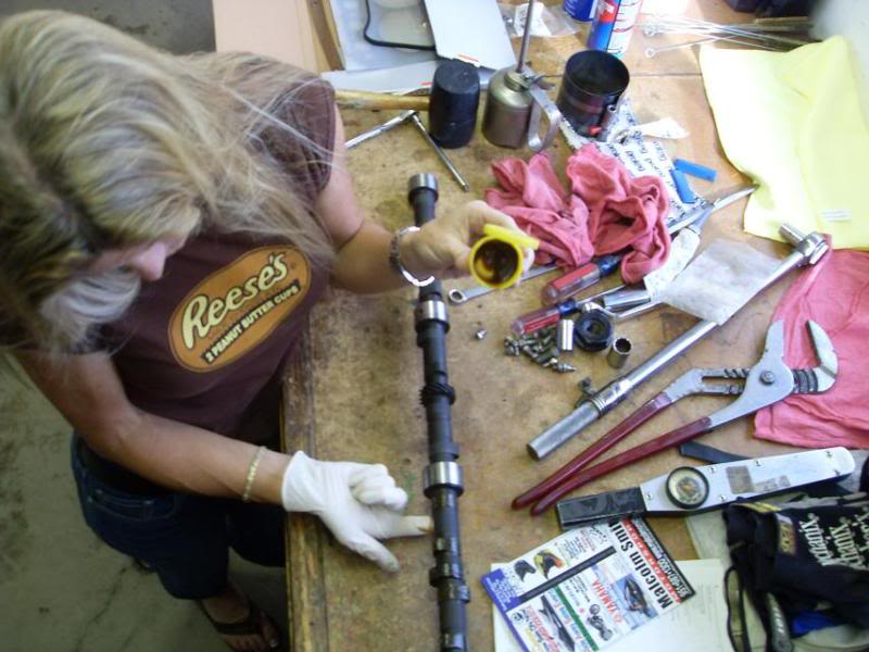

I'm glad you like the toys, I know I do. I recently sold the FJ80 and bought a 05 Sequoia LTD. The FJ40 got a total resto here in my shop 5 or so years and 50K miles ago. My motorhead wife and son were helping me assemble the motor in this pic. Pretty cool that they like doing this stuff too!
How about the little woman lubing the bumpstick (that sounds bad) prior to install.
You are correct in what I'm thinking. In my head I built in a fudge factor in case the heads might need parts, but I assume they won't. The machine shop will probably want to at least clean the heads and grind the valves and seats if nothing else, that will cost something. I just put a straight edge on the head and block and found less than .002" flatness on most of the heads and block with one spot at less than .003", I think that would be less than the max of .0039" spec. If I could find some good used pistons, I could gamble on honing the block, throwing some new rings at it and seeing how long it will go. Even there, I'll be in it $700-$800 (gasket set, rings and head bolts) and no warranty or I could gamble on a used engine with a 90 day warranty for $1,000.
